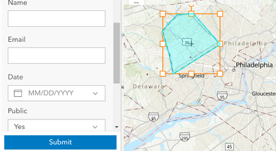

Faiez
Hi!
Just select the impacted area and create the new report, the submit button already exist.

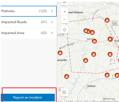

KimSapunar
Hello,
In your example above, do you have one feature layer with "potholes, impacted roads, etc" as field with domain values?  Or more than one layer?  I want what you are showing - when a user goes to create a report, the available categories are listed, then click to fill in a comment, etc.
Thanks
Kim
SubaKrishnan
Hi @KimSapunar Potholes and impacted roads are individual layer. They have domains in it and it can be configured in the feature form in the map viewer. A report is created by filling out a form, and on the created report, user will see a comment button to submit a comment. Please remember both of the features needs to be configured in the report config panel.  Here are some blogs that could help you better. Please read them if you've not already.
