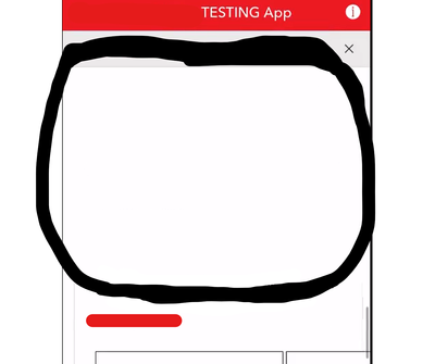

I was wondering if you knew how to remove white space from the mobile view of the Zone Lookup Instant App, however? It seems like when I scroll through the popup on the application there is a large white space that prevents me from seeing a lot of the content.  I've circled in the screenshot where all the white space is, and the red is where the content of my popup begins. I know this doesn't have to do with the HTML/CSS code as another one of our Zone Lookup Instant Apps does the same thing on the mobile view and does not use any HTML. Thank you again for your help!
KellyHutchins
Esri Notable Contributor
Thanks for the screenshot but I can't reproduce the issue with extra whitespace that you are seeing. Are you able to reproduce it with the default sample app?

I am not able to reproduce the issue with the default application provided above on mobile view. Our instant apps tend to have the map turned off, however, and we also use the custom CSS option to remove the "results" tab in our Zone Lookup Apps. The attached post has the CSS that we use. I'm wondering if either of these would cause that extra white space in the mobile view?

Try adding this to the custom css and see if it helps.
@media only screen and (max-width: 859px){
  .no-map #resultsPanel {
    height: calc(100vh - 100px);
  .no-map.panelSize-s .gt-container,
  .no-map.panelSize-m .gt-container,
  .no-map.panelSize-l .gt-container {
    grid-template-rows: auto auto 0 1fr;
emoreno
Hi Kelly,
That CSS does appear to be working and there is no more white space in the mobile view! Thank you for all of your assistance!
