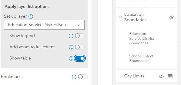

I have a Sidebar application with a group layer. When I turn on show table for a layer in the group layer the table icon does not appear. When I do the same workflow for a layer that is not in a group the table icon does appear.
Is there a special workflow to show tables for layers in groups? I would prefer not to un-group the layers.

Is your app public? If so can you share the link? I ran a quick test with a map with group layers and it worked in this app: https://jsapi.maps.arcgis.com/apps/instant/sidebar/index.html?appid=1bba0729b7344be7be4c9f05b5f8716b
ArielLow2146
@KellyHutchins thanks for checking! The app isn't public but I think I figured out what is happening.
I'm able to see the table icon in the group layers when I publish but am not able to see the icon in the draft view that is part of the configuration screen unless I refresh the page. I didn't think to check the published view till now since nothing was happening in the configuration view, sorry about that.

Ah good to know about the draft version. I’ll create an issue so we can look at fixing the draft update in the next release of online.
