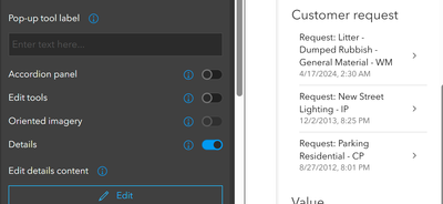

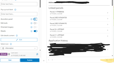

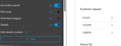

On the sidebar instant app, if the "Accordion panel" was turned on, the pop up panel will not follow map pop up settings, like the title of the popup. Also, for a map will multiple related tables, if the user click the details of the related record, then go back, only the current related records will show up, all others will disappear. Works ok when the "Accordion panel" was off.
Accordion panel on:
Accordion panel off:

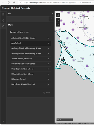

Hi, @KellyHutchins Thanks for the DEMO app, I can reproduce the second issue on Edge Version 137.0.3296.83 (Official build) (64-bit).
If I select a county on this demo, it will show both Golf courses and school results. Then click any of the related record details and go back.
The info panel now only shows "Golf courses result" or "Schools" result, depending on which one user clicks before.
Before checking details;
Check any school detail and go back, the info panel now only shows related schools, golf course disappeared.
