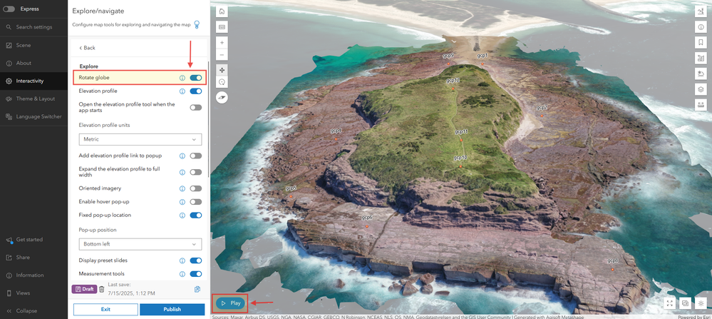

hkomm
To anyone landing here and curious about where the option is in the Instant Apps (3D Scenes) - please see attached screenshot
