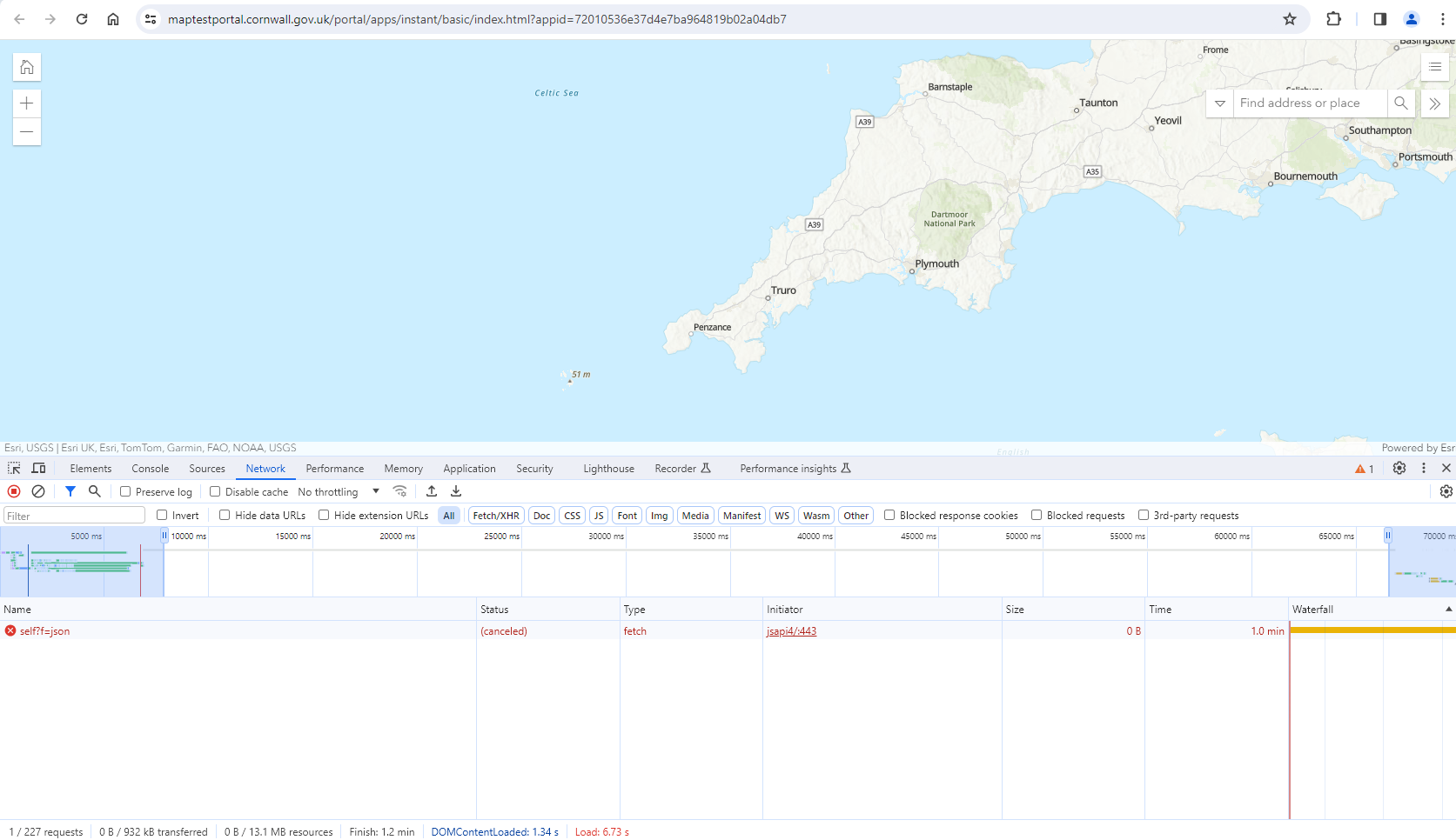

I have built a basic Instant App in ArcGIS Enterprise and it is very slow to load in both Chrome and Edge. There is a stage where it pauses for exactly one minute every single time, then once it has loaded, the speed is fine. This happens on every Instant App I build in AGE (ArcGIS Online is fine). We have an 11.2 and an 11.3 environment and it happens in both.
I used the browser console to investigate the issue. The app makes this request: https://maptestportal.cornwall.gov.uk/portal/sharing/rest/portals/self?f=json, waits for a minute for a response and then the request is cancelled:
If I open that URL in a new browser tab, it responds within a few seconds.

It's fixed!  I don't fully understand the magic our Networks team wrought, but they told me they added the server URL to a group on the firewall that "allows access for sites which are non-proxy aware".
It may be just a peculiarity with our configuration, but I thought I'd post an update in case anyone else has the same issue.  If it's something you are stuck with, contact me and I'll be happy to pass on more details.
