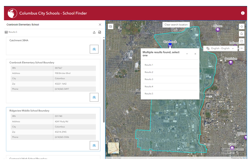

Chris_Kell
I'm working on the same IA for the same purpose.  Following an address search my point layers (schools) are appearing under the zones.  When a users clicks a school for additional information they are presented with the following.  Any help will be greatly appreciated!ia pop up.png
