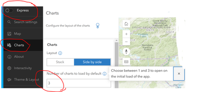

Hi, I think you want to turn OFF Express mode in Chart Viewer (it is a toggle on the top of the left sidebar), then, go to Charts (on the left sidebar) and select the Number of charts to load by default. This works for me to see multiple charts (by default) when viewing in Chart Viewer.
