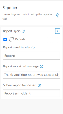

  • Reporter options: Select reporting layers (only applies to editable features), configure report button text, configure report submission text.

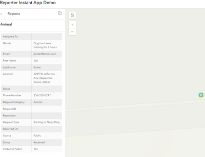

Reporter (beta) displays all the editable feature layers in the side panel. To view a report, the user selects a layer from the list and navigates to the desired feature to view the details. Alternatively, interacting with a feature on the map opens the popup details of the feature on the side panel if the feature is from an editable feature layer.
To submit a new report, the user clicks on the ‘Report an incident’ (configurable text) button either from the main layer list or within a layer to submit a report. The intuitive workflow lets users add or draw the feature’s geometry on the web map and enter the smart form with additional details, along with an option to attach related multimedia. The recently added report appears at the top of the feature list of the layer.

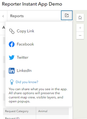

Share functionality
To share, the user clicks on the Share button on the side panel to open the Share dialog with options to share the feature details, and the web map.

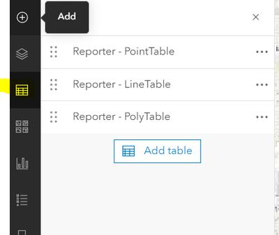

KimSapunar

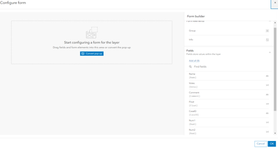

I was a regular user of the crowdsource polling app, using the 'comment' feature on attributes.  I have a test map using the new Instant App Reporter.  When I add my geodatabase with an editable layer and a related comment text file, I can't access the fields from the related file in smart form within Map Viewer.   I think I'll need to do this first, so that in the Instant app the relate ID field would be hidden, etc.  Do you have a suggestion? Thanks
SubaKrishnan
@KimSapunar Could you verify if the table shows in the TOC ? When you select a layer >Forms and you  see the second screenshot?
Yes, you've to configure the smart form first before using it in the app.
If you still have issues with map viewer, please contact esri support. Thank you!

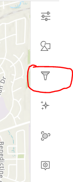

DavidG
Occasional Explorer

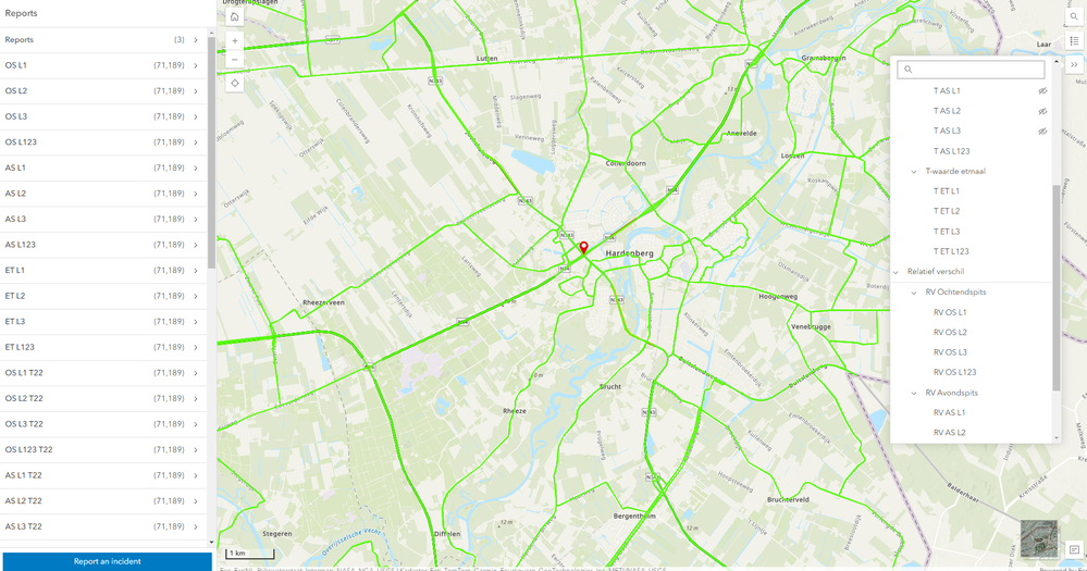

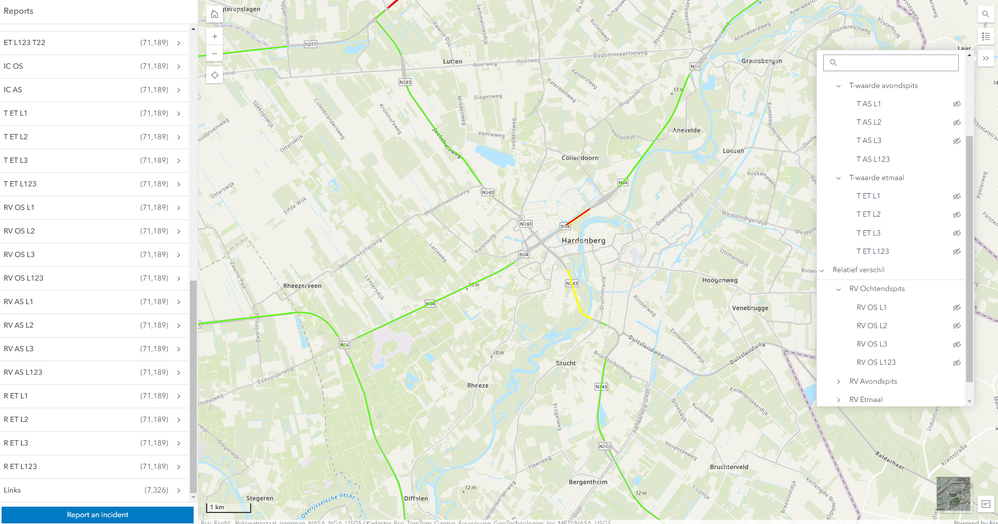

Hi @SubaKrishnan I'm using attribute filters in the config. Is it even possible to use filters in the mapviewer? I could not find that option.
As you can see I have the same layers in the left section (panel) as in the right section (layers) because I need attribute filters on those layers and this is the only way I could find to do that (If you have another way, please let me know).
So, in the first image, all layers are turned off except for the one I want show. However, when I leave a report (second image), all the layers below the one I had on, automatically turn on, which means I have to manually turn them off one by one again."
Ideally, I would like to make the layers visible only in the layer view, but I can't find a way to apply an attribute filter on those layers, except in the config under the reporter section.
SubaKrishnan
Hi, @DavidG Yes, you can set map filter and it's not dynamic as attribute filter. The option is on the left ribbon in the map viewer.
Are you turning off the layers in the map viewer but it turns on as you interact with it in the app? This issue you're noticing is a known issue and it will be fixed in the next release, and when the layers are off in the webmap, it will not be rendered on the map but it you still report on it, if its report collection is enabled on the app config. Hope this helps. Let me know if you've any questions.

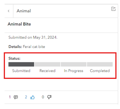

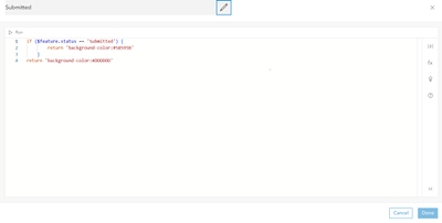

LinzMess
@SubaKrishnan

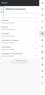

I would like to enable the status bar in the report details similar to what is shown in the Introduction Blog post for the reporter app dated June 27, 2024 ArcGIS Instant Apps: Introducing Reporter
Is this still a feature? If so, how do I configure the status bar?
Hi @LinzMess   You can use attribute expressions in Map viewer and edit the layer's popup to make use of these
SubaKrishnan_0-1731977599450.pngSubaKrishnan_1-1731977619041.pngSubaKrishnan_2-1731977657168.png

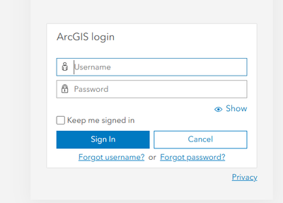

MarkNewman
@SubaKrishnan @Amanda_Larson
I have configured an Instant Reporter App, see Street improvements Reporter ,which is getting a lot of use, however I have had feedback from a number of users that when they go to submit a request, users can click on a location on the map or use the address search box
If the user uses the address search box the application will ask them to log in!
As most users will not have an ArcGIS online account this is not possible!
As I have always been logged into ArcGIS Online when configuring the app, I did not notice until users fed the issue back!
I have gone through all the configuration options and have not found a way of rectifying this issue!
Are you able to help?
BethRomero
@MarkNewman by default the Reporter app adds all locators in your organization and one of the locators must not be accessible to app users not in the org. We are looking at adding in an option to configure the search locators in the form. In the meantime, if you remove the locator from the Organations settings (Org settings < Utilities < Geocoding) that will fix the prompt to sign in. In my test, the locator that seems to be causing the issues is OS AddressBase (Internal).
