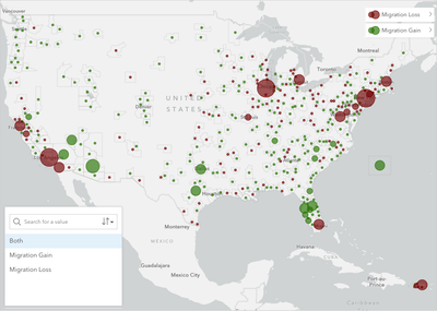

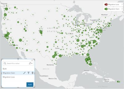

You could use Predefined Filters to accomplish something that is functionally the same.
This map has two layers and I've added the appropriate filters to toggle each layer. Clicking on one of the layer filters will remove the other layer from the map.

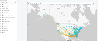

Good day Scott,
Nice to see you again, so if you look below, you will see that the layer on the map is not in the contents pane, so I don't know how to bring it to a predefined filter.

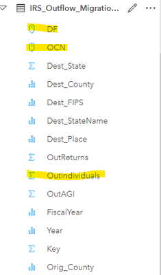

And highlighted are the columns used to create the link map, by selecting them and then dragging them over the map which then creates the layer seen in the first screenshot.

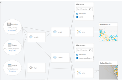

Yup, and so the map will have two layers for inflow and outflow. Right now these two layers are based on two separste datasets.
