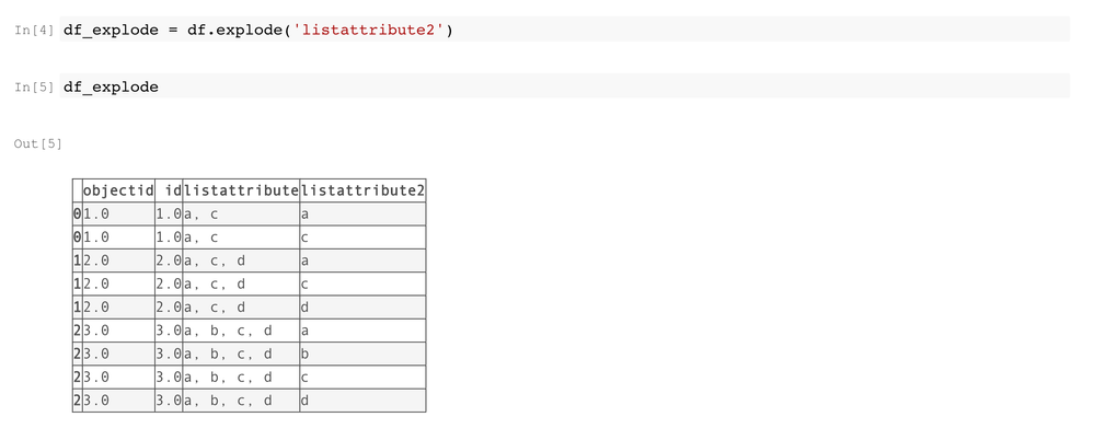

2.  "Explode" the list into separate rows

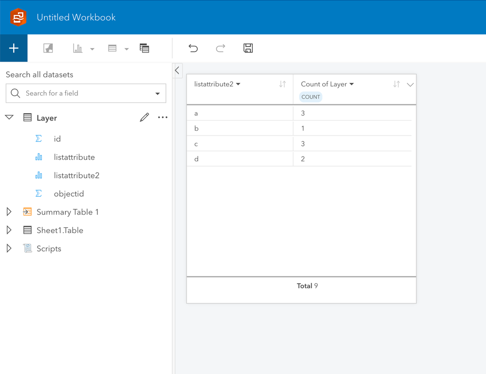

Now you're able to create the Summary Table
