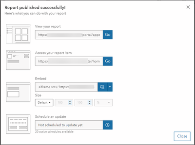

One  way to not have the banner would be to use the iframe, you could take the iframe link from the "Report published successfully!" page (also where you find the link to your report) details and place the iframe within another website or story map. I frames only contain the workbook contents not the banner.

@BenjaminWhite5 what would you like to implement? You can edit the banner and customize branding for your brand/organization or embed the report using the iframe tag not to show the banner.
