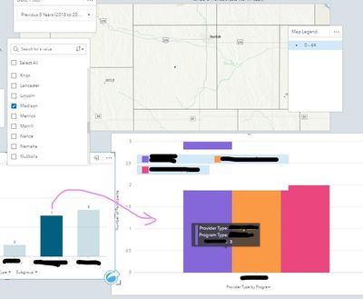

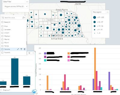

Hi - So sorry! I don't get to Insights often and the program I was working with didn't want to use this option, so I cannot link to a finished product that uses this. The end user has to be aware of all the options selected for this to make sense. Our needs were more basic and had to apply to a larger audience.
What I did to navigate around this not working as expected was set up a series of filters that pile on top of each other as you navigate down the page.
For me this looked like a temporal filter, county filter (using a table or map), and then 2 additional bar charts (that act as filters). Not exactly what you were looking at doing, but maybe this will help you find a workaround.
