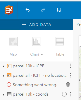

I am attempting to access spatial data from Lat, Long columns in a table drawn from a SQL Server table view. The source data has approximately 242,000 records (parcel centroids for a local county government). I can load the table without issue into Insights, but if I attempt to enable a location (using the Lat, Long coordinates) I get a message that says "Something went wrong". No more details.
Insights Error message
This seems to be a problem with the SIZE of the table to process. I CAN enable location on an subset of the source data using a SQL "select top 10000" table view.

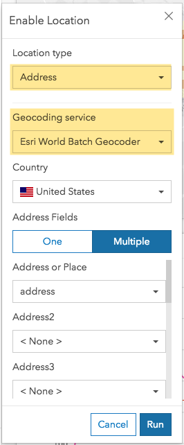

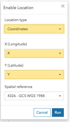

Does your SQL server location data have "X and Y" information?  If so, can you please try that and let me know if that works for you?  (X,Y does not use geocoding service - so trying to narrow the problem down)
AndrewMurdoch
The "lat" column is the "Y" column and the "long" column is the "X" column...
I'm passing in decimal degrees in EPSG 4326...
My source data is in Maryland State Plane Feet, but I've had to convert those "X,Y" values to decimal degrees prior to import to Insights, as projected coordinates (other than WMAS) don't seem to be supported yet.

"I'm curious what "geocoding service" you refer to and when it is activated? Is this only for "address" type locations, as I'd expect?"
I was referring to what method are you using "Enabling Location" with Insights?
or using the Geocoding Service?

Yes, I'm using the "Coordinates" option in the "Location type" dropdown, with decimal degrees, latitude and longitude coordinates.
And I get the error I initially reported (but only for SQL tables/views with more than approx. 50k records).
Using the long,lat X,Y coordinates as location input does not work for me with this data set...
