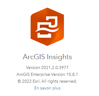

I have this version of Insight:
And I use a Feature web service using data in an Oracle Database (SDE)

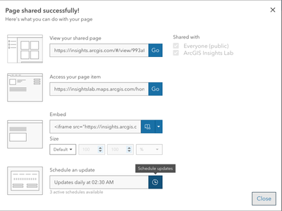

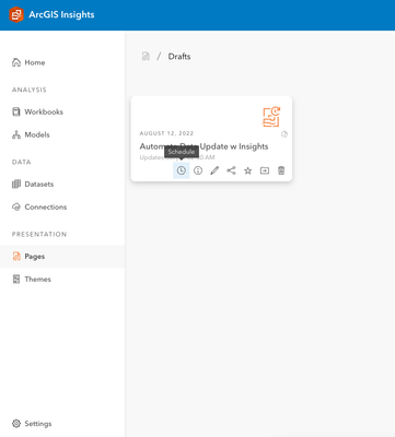

If so, you'll want to utilize schedule updates for shared pages. This will ensure that your data is current (given the schedule you setup) on your shared page.
It can be accessed via the share page workflow or on the Pages tab.
