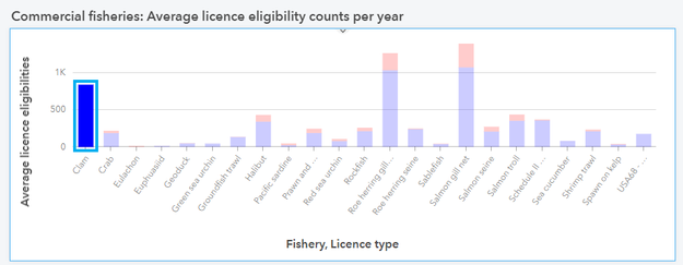

Developed with Insights Enterprise v2023.2, for the categories in following chart, any way to change the font size?
Based on the official documentation, it is accessible but tried both screen reader Narrator and JAWS none of them can read out the categories.
https://doc.arcgis.com/en/insights/latest/get-started/keyboard-shortcuts.htm
Thanks for any help!

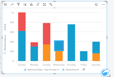

@Ming Thanks for the question. Unfortunately, there isn't a way to change the font on categories.
I was able to use Windows Narrator successfully on a Stacked bar chart using Win10 & Google Chrome. you want to use keyboard navigation ("Tab") button to navigate to a category and highlight. Let me know what browser and OS you are using and I can see if there is an issue.
Thanks,
Akshay Harshe

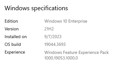

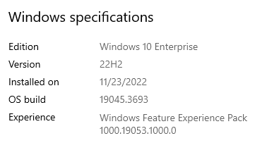

@Ming I don't hear that, For me it says the Category name. e.g. In my example, it says "<#> Wednesday Menu item"
I am using a newer update to Windows that yours, Maybe Narrator has some updates? See if you can download updates online.
This is my Chrome version
Let me know.
Thanks,
Akshay Harshe

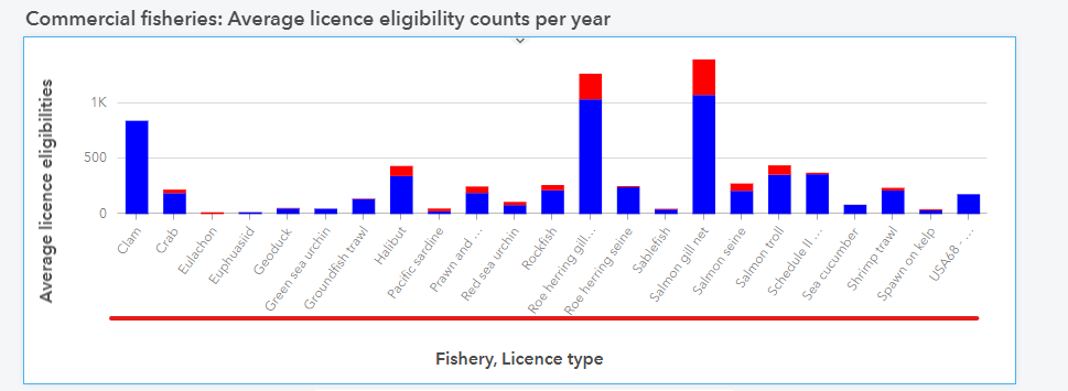

The data source is csv. I did more test, looks it is related to the category count.
This one has 16 categories, it can read out category names:
https://insights.arcgis.com/#/view/03f1ae8120df4615b41c4998327692a8
This one has 23 categories, then can't read out category names:
https://insights.arcgis.com/#/view/e44a70dfc3a04d47a086aeafa6dd3508
Same data source, same environment, same operation.
Maybe the threshold of the category count is 20?
I will also do further test.

@Ming  I appreciate you doing the testing and narrowing it down! I can reproduce this.
I am not familiar with VPAT support but it seems like this could be by design and if the number of categories exceeds a certain number then it skips the narration. This is probably to avoid getting stuck on the card for a long time. It also happens to Scatterplots.
When I navigate to the Stack chart narrator does say "<chart type> chart, visual aid required".
I will confirm with someone on our team.
