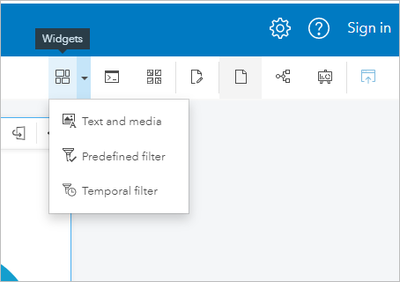

The first is to create a predefined filter widget. This can be found in the top right of the workspace (see image)
You can set this up to use fields from your data - such as building name. And if you only want your viewers to be able to look at one building at a time you can go into the `Card Options` > `Appearance` and set it to be a single select ot a drop down and your viewers will be able to select the relevant building. Note that using a predefined filter will filter every card on the page that uses the dataset you chose to filter by.

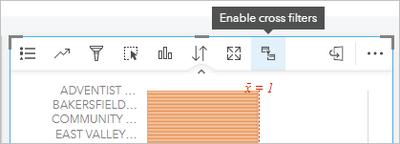

For your second comment about selecting on one card highlighting the relevant components on another. If you want the selection to filter the other cards you can turn on `Cross filters` on the cards you wish to be filtered by your selection. This option can be found at the top of each card.Turning this on will mean that the card that has the setting will be filtered when a selection is mad on another card using the same dataset.
