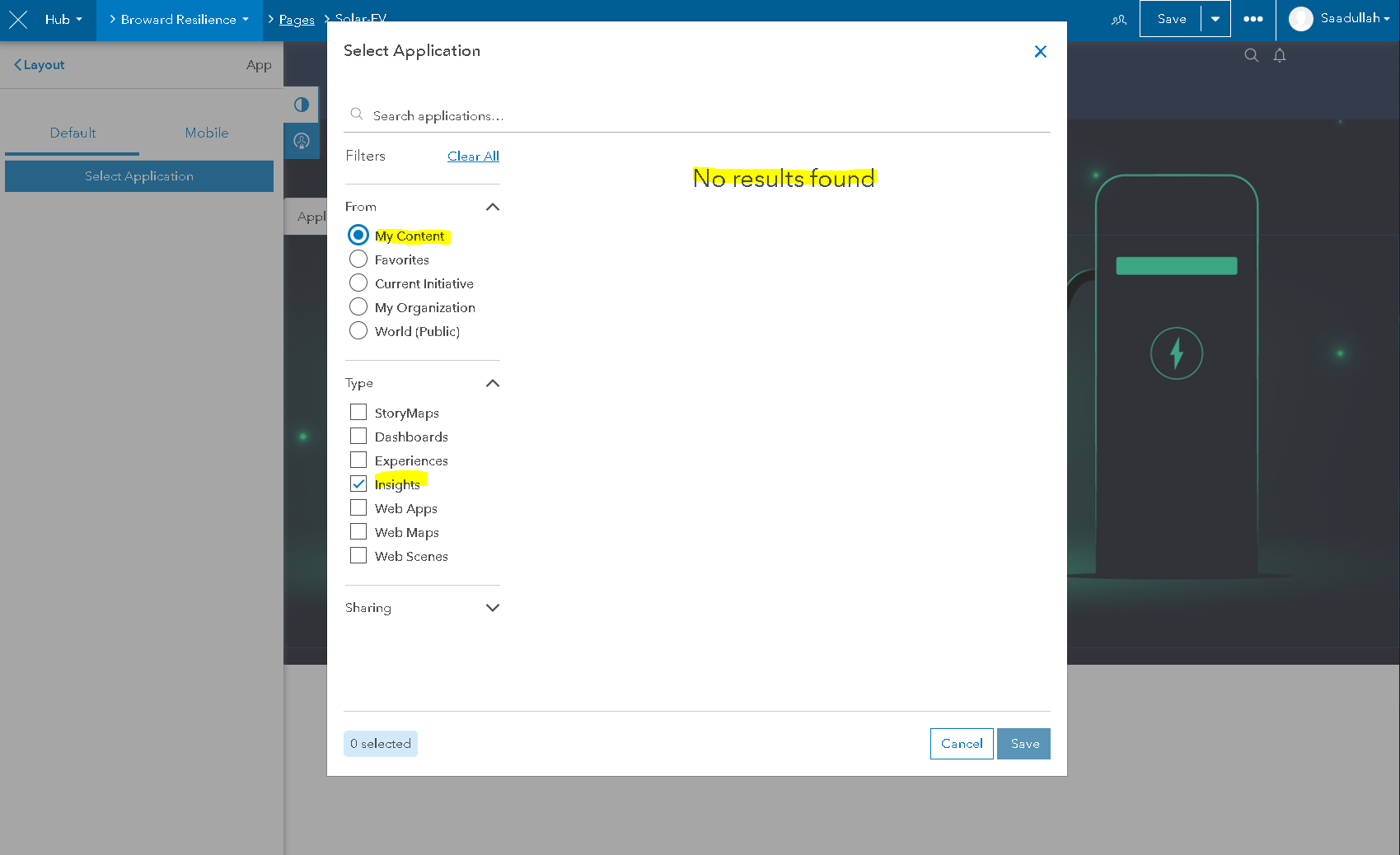

Good day,
Hope all is well, I created an Insights (online) workbook shared with the organization and relevant group. Now I am trying to embed that workbook in ArcGIS Hub page using the “App” widget, but I get a message stating “No results found” .
How can I fix this?

Embedding the workbook itself into ArcGIS Hub isn't currently possible but embedding shared pages is.  Are you wanting users to be able to make changes to the workbook?  If not, I think the shared page might be an option that would work.
If needed, I'm happy to have a call to walk through your full scenario.

Are you trying to share the Insights workbook itself or a shared page created from the workbook?

Insights workbook itself.

Cheers Scott that worked.
