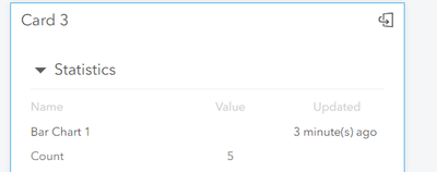

You should find the last updated date on the back of each card. there is a button to flip the card around
Note that if you have cross filters enabled then the data on the shared report can be part Live and part static. e.g. A bar chart will be live but the card Calculate density might be static. This means every time you reload the browser you will see the updated date on the live dataset but the older date on static ones.
The scheduled refresh will update the entire analysis so all the datasets will be updated at this time.

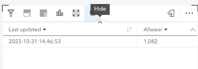

  1. Open the data table on your dataset
  2. Create a new field with the formula `TRIM(NOW())`: this should create a new date column as a string.
  3. Name the column Last updated, Hide the header bar
  5. This will show count expand the column width that the count is not visible
  6. Optionally you can remove the card background to blend the card in with other cards

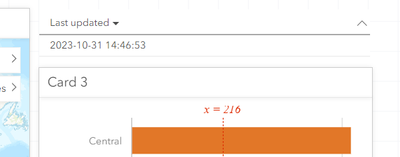

  7. Go to the report designer make the card even smaller and hide the bottom section with another card as such: AkshayHarshe_2-1698765236140.png
Now this date should only update when the scheduled refresh happens.
If you really want to display the last updated date you can use the hack below:
