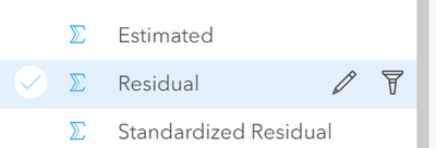

The predicted variable should include the predicted fields and residual value etc. You can open this dataset to check out their formulas
