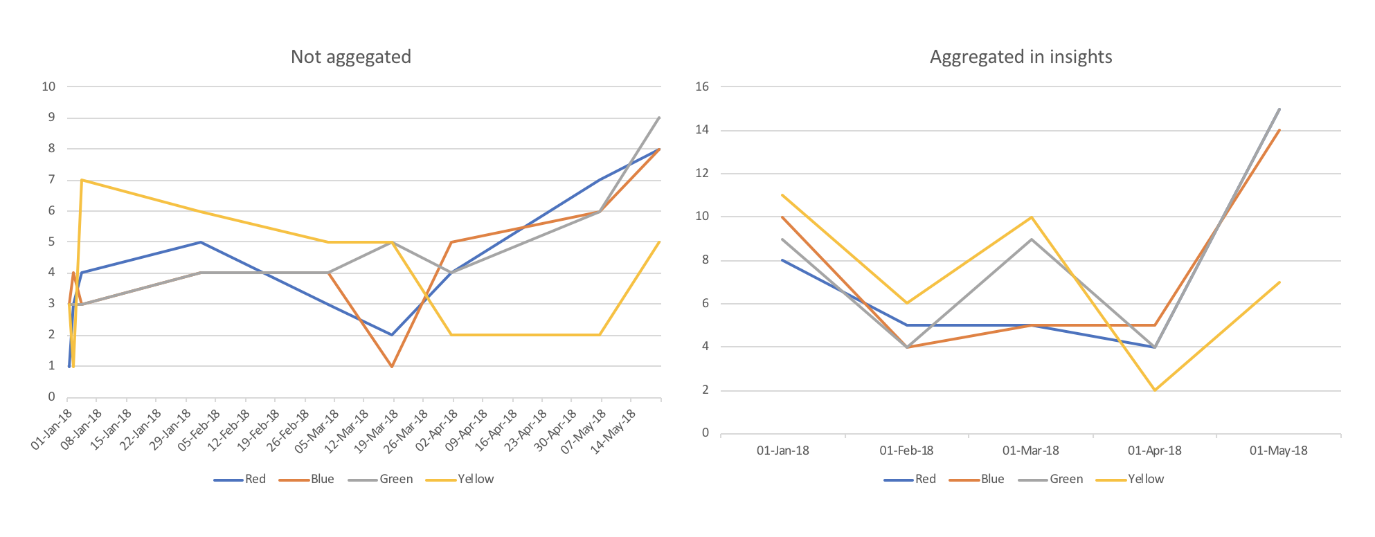

I have a series of observations for 4 catagories taken at random times over a 2 year period that I want to display in Insights.  On occasion observations are captured once a week, sometimes once a month for all 4 catagories.  The issue I have is that Insights automatically chooses the time periods along the x axis and aggregates the observations during this period into a total for that period Insights selects.  I don't want to know the total aggregated during the period I want to maintain the actual count.  The graphs below demonstrate this.  They look completely different due to the automatic aggregation.  Does anyone know how I can overcome this problem?
Aggregation
LindaBeale
Hi,
This is a great question and is a frequent topic on conversation in the team. As yet there is no way to change or modify it.  This is something we would like to address in a future release.

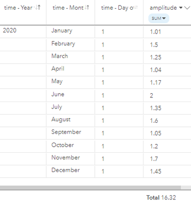

I have a simple table with one record for the first day of each month:

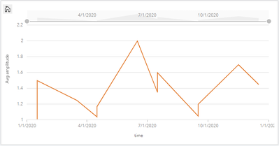

Yet Time Series overlaps the date intervals in some random dates instead of plotting the count in the precise date. This generates spikes that convey the data is incorrect.

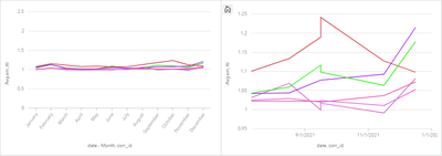

A workaround could be to use Line Chart instead of Time Series. However, Time Series can calculate the scale much better the the Line Chart.
In this other example the attribute value is much smaller. The Line Chart displays it correctly but the scale makes it much harder to read the the Time Series:
Is there a way to adjust the Line Chart scale?

The workaround using line chart that I've suggested end up not being a good solution.
My data rolls over one month every month. So, if I try to represent data from Feb 21 to Jan 22, using the  month attribute from the date field, the line chart won't consider the year and the chart will always start from January and end in December.
Maybe adding a sort by another attribute would solve this issue in this particular case, but ideally I would like to use the time series.

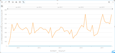

Hello. Is it possible to have multiple times series lines in a time series graph? For example I performed Time Series Clustering in ArcGIS Pro. I exported the resulting chart to a csv file. But when I import the csv file into Insights all of the Time Series Cluster IDs are merged into one field that I can't figure out how to separate.
Scott_Aulen
Leon,

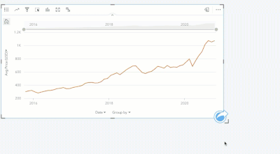

This is definitely possible within Insights. After adding the Time Series chart, select Group by to determine the field to display.
From your comment though, it seems that your data is being transformed upon import into Insights? I don't think that should be occurring. Is it possible to send a copy of the data?
Scott
LeonKincy
I have 3 variables date/time, sum, and cluster id. Originally all three fields were creating on line graph. Which I think would have allowed me to do the group you mention. But now I get two lines. I'm not sure what to do.
LeonKincy
Each record (row) has 3 fields. Looks something like this. 5 cluster ids per date.
The date and sums form one jagged trend line and date and cluster is form a flat line.
