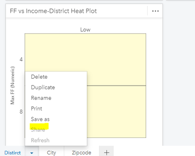

I have a workbook that has a fairly large dataset on Insights desktop (2021.3) and when I try to share the page on AGOL. The page share option is greyed out.
How can I fix this?

In order to share the page make sure to sign in first.
