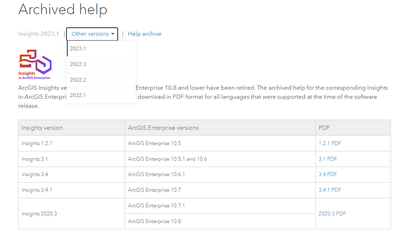

We upgraded our Insight to Version 2022.1.1.4568 and were able to add the Teradata connector type successfully. We were previously using Version 2021.3.1.4259, which I am assuming didn't support Teradata maybe. I couldn't confirm this as there isn't any info available in archive for Version 2021.x.
Archived help
Archived help
