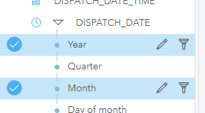

We have a dataset of millions of records that are incidents from our city 911 dispatch system.  We would like to be able to show a rolling number of months (e.g. 12) in data in bar and column charts.  Right now we can only filter by year or month, and if we turn off the year filtering it stacks multiple years (see attached chart -- notice how January is more overall, because it's three months of data, vs the other months have only two).  I know Tableau can do this -- in fact, I think it defaults to this in some way.  I've attached an example Tableau chart I found that shows this.

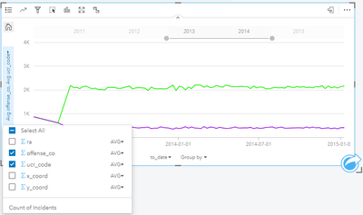

I think you can achieve this in several ways in insights. The easiest being the time-series chart by dragging and dropping a date field.
- It is easy to filter dynamically using the top slider bar
- You can have more than one series or group by a category

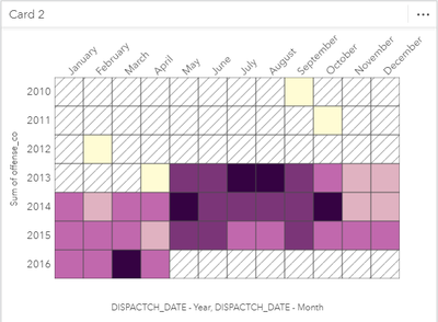

The second option, if you want to see Year/Month against a statistic a Heat chart or a data clock might be a good fit. From the date,  components chose Year/ Month and a numeric field to create a Heat chart or a Data clock.
You can also pair this chart with a Cross filter or Pre-defined filter to choose single or multiple years. It should look something like the following. I personally find it more readable than stuffing many categories in one bar/column chart.

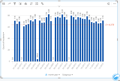

Lastly, If you need a bar or column chart (Stacked or unstacked) you can calculate a new field and use that instead of the date components.
  1. From Layer's menu open data table
  2. Add a new field called "Month - Year" and use
  3. `CONCATENATE(month,"-", year)`
  4. Use this new field to show a bar chart e.g.
Let me know if that helps. Sorry for the long post. Feel free to ask any questions.
