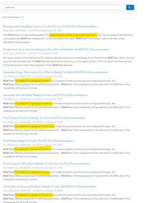

How are you all computing walk_time in your Indoors networks? Does Esri have a standard recommended calculation for this based on shape_length? If so, apologies, I couldn't find it through searching.
It seems like Esri Network Analysis defaults to 5 km/hr. Has anyone worked on applying different walk_time calculations based on different mobility modes? for example 5 km/hr for "Walking" or 1.5 km/hr for a "Manual Wheelchair" (based on an arbitraty Google Scholar search, https://onlinelibrary.wiley.com/doi/10.1155/2012/753165
https://pro.arcgis.com/search/?q=walktime&collection=help&product=arcgis-pro&version=pro3.4&language...

    A: You correctly determined that Network Analyst uses a default walk_time of 5km/hour (3.1mi/hour). I'm not sure what reference was used to decide that that would be the default; could be that 5km/hour was a nice round number in the generally-agreed-upon range of 3 to 4 mph (4.2 to 6.4 km/h) for an average adult human walking speed. This study could be helpful; it gives a "usual" outdoor walking pace as 4.7 km/h (2.9mph).
