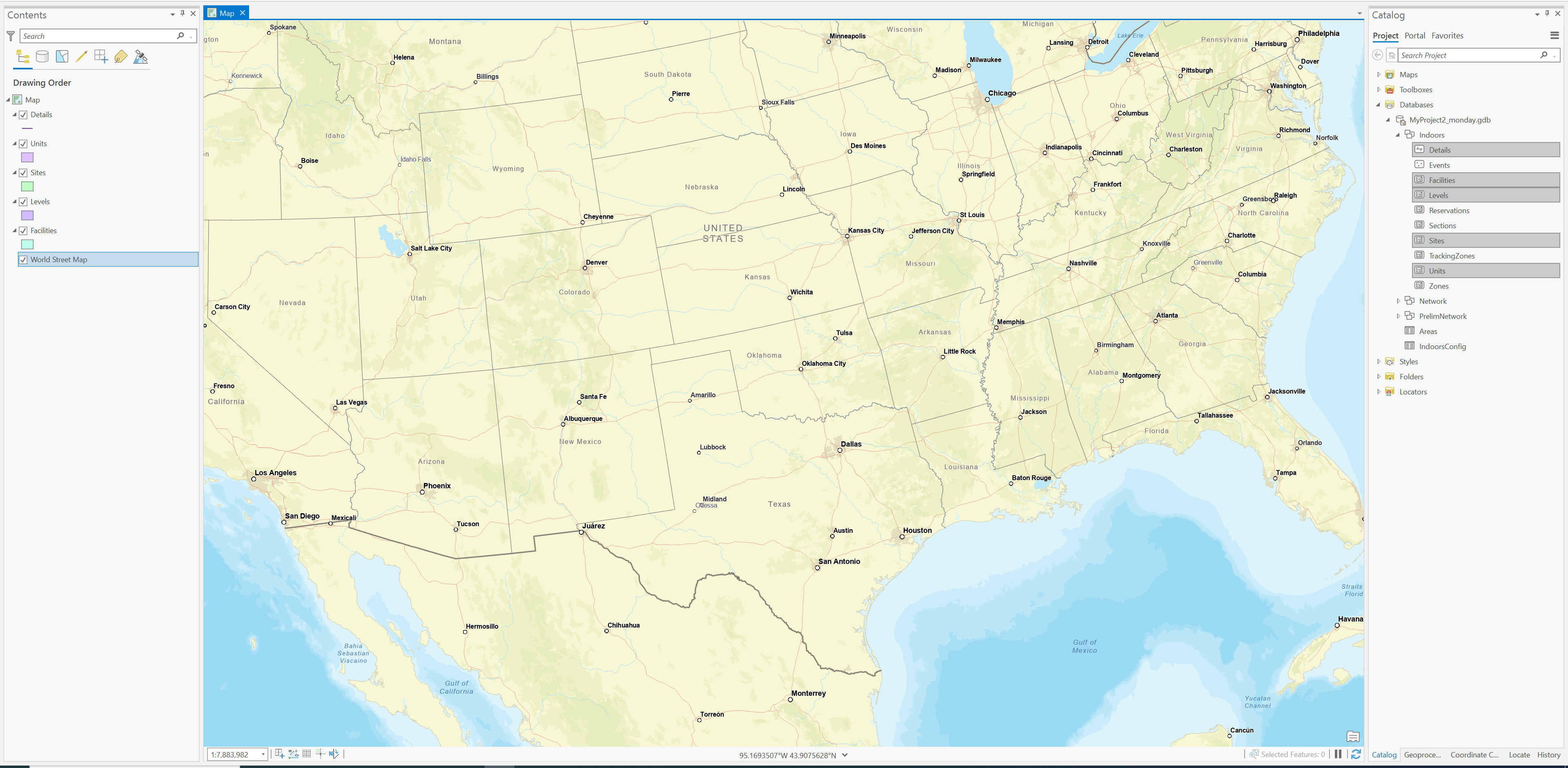

Hello Team,
After running the Import Floorplans to Indoors Geodatabase, I removed the imported polylines from the Contents to have a better look at he Indoor layers. I even added my my Indoors layers from Catalog to the Current map. Unfortunately, I am unable to see any layers (facilities, units etc) after zooming to those layers.
Kindly help me out with this issue!
Thanks and Regards,
GauravJobanputra
Hello @SusheelasriAkunuru can you right click on a layer to open Attribute table and confirm if there are any records? If yes, then right click on any record and select Zoom To. If no, then you need to make sure you added the feature classes from the same database where you loaded indoor data.
