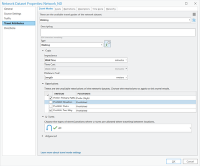

Assuming you've created the correct transition features, you can also try 'forcing' the default walking mode to prohibit using the elevator (transition) feature from the network dataset by placing the check mark next to it.
You'll have to re-publish/overwrite the network service also once you make a change.
