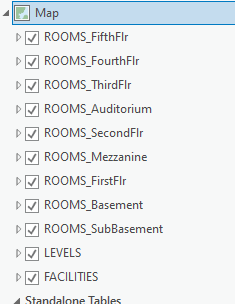

Hey! I just got the Indoors extension and I am trying to create a floor aware map to be published on AGOL. When I go to Map >> Properties >> Indoor Layers I am unable to select anything for Facilities and Floors... the drop-down has no options. I believe I have the appropriate layers in the map with the correct schema. Anyone know why this would be and how to fix it?
Second question, I have multiple layers for my room level data, one for each floor. It was necessary to do this when they took the floor picker away from FieldMaps so we could filter the rooms by floor (and it worked just fine with the floor picker before they took that away). Now I have the Indoors license and want the floor picker back. Is it a problem that I have these multiple layers? Pic below to show what I mean...

Answer: If you are able to see the Indoor Layers option in map properties then you have the license applied correctly however the feature classes in your database may not match the layer requirements for to configure floor-aware maps. You should use the Create Indoor Database or Create Indoor Dataset tools to get the expected schema.
Question 2: Is it a problem that I have these multiple layers for each floor?
Answer: Floor filtering is designed to work in maps that have the properties set from Question 1 and for all layers that have the Floors property. You should set it on a single Rooms layer if you had all the data in it.
The floor-filter will appear right away after you set the map and layer properties mentioned above.
