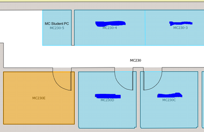

On your units feature layer, use the Assignment_Type field for your symbology. Then set your symbology as None=Yellow, Office=Red, Hot Desk=Red, Hotel=Red or whatever colors you want to use.
It's important to do it on the feature layer because if you don't, the colors won't change until you refresh your viewer.
After setting it up, you'll end up with something like this where orange in my case means none:

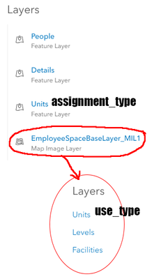

I symbolize by USE_TYPE on the Units in the underlying map image layer and then by Assignment_Type in the overlaying feature class layer. This results in my Units layer being in the Web Map twice.
