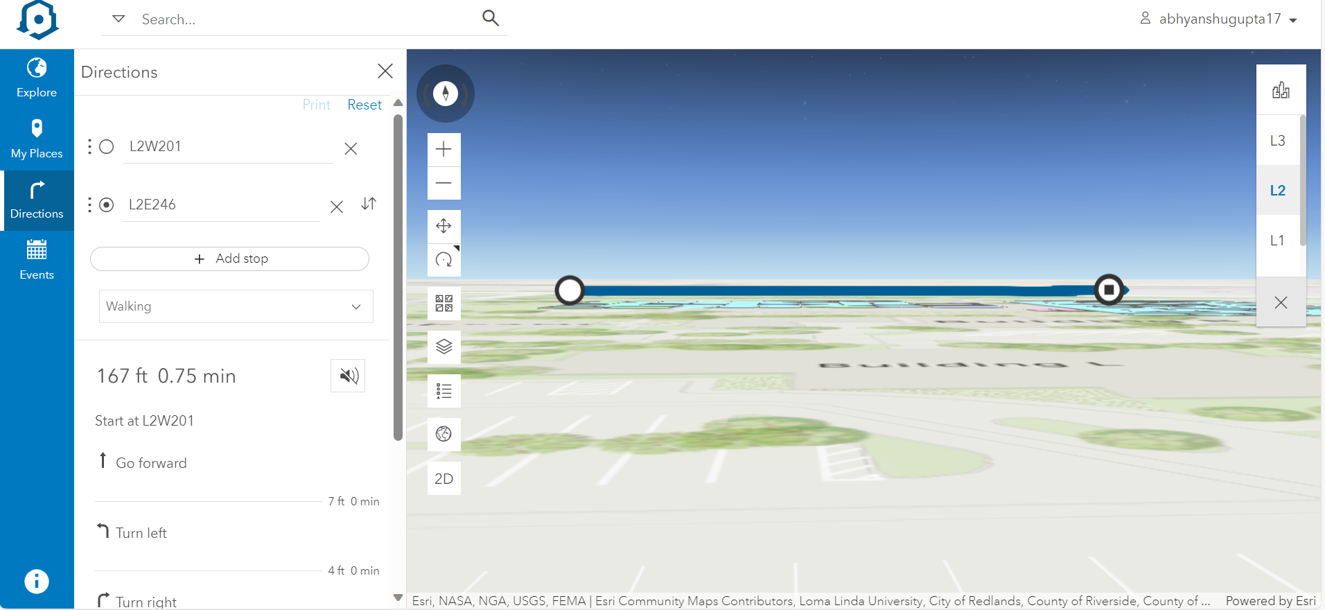

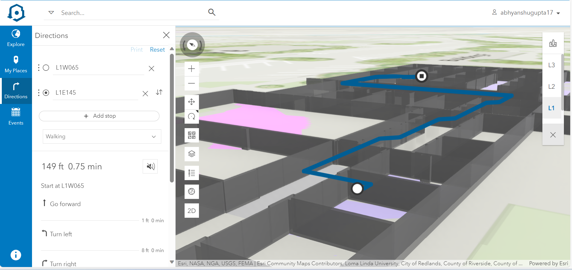

I was trying to add walls to my 3D scene of indoor dataset. After doing that successfully my route layer is a bit elevated that is before adding walls geometry, routes were grounded but now they are elevated to some extent.
This is a screenshot where routes where grounded.
Here routes are elevated.
What could be the possible cause?
Steps that I have followed to update units as after adding walls my 3D model was elevated from ground:
1. Added a relative Elevation field to attributes of units layer, configured for every level.
2. Updated properties of Units layer for Scene where elevation is marked with "A field" and selected Relative Elevation from the drop down.
