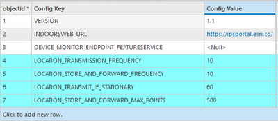

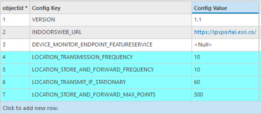

it is my Indoors Config table. it's shared as a hosted table and it's referenced in the MMPK.

@SimonMarin the TrackingZone layer also needs a feature and TrackType needs to be set to Track. Pls check and confirm.

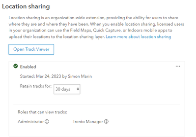

Do you have Location Sharing enabled in your ArcGIS Enterprise?  It is not a default capability, as far as I know.
Configure location sharing—Portal for ArcGIS | Documentation for ArcGIS Enterprise
GISP
SimonMarin
Hi Michael.
Yes i have Location Sharing enable on my enterprise
and i have deploy the Tracking Zone Feature layer.

GauravJobanputra
SimonMarin
Hi @GauravJobanputra Yes.
I got it. in my MMPK i dont have referenced the  trackingZone feature layer.
I republished and it start to share location.
