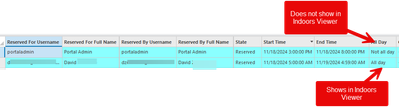

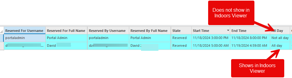

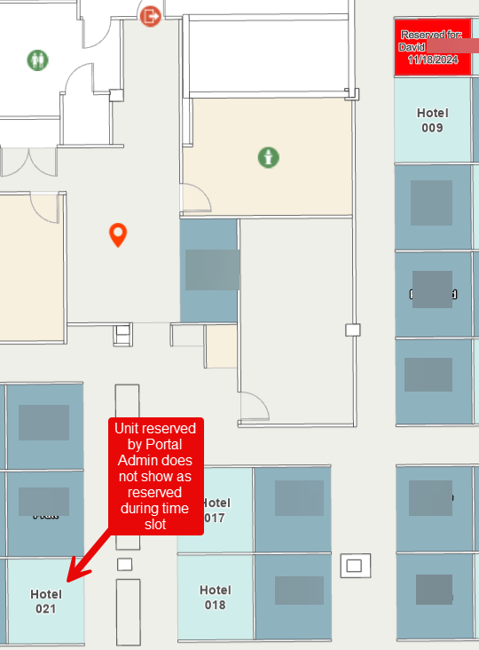

I have Indoors Viewer setup for my organization to reserve Hotel desks.
When a Hotel desk is booked for a few hours, it does not show as occupied in the map view.
It shows as booked when going through the book process.
I need the map to show the Hotel desk as reserved during the time window so users can visually see what is available at the time they are looking at Indoors Viewer.

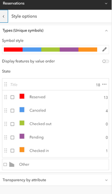

Hi Marisa, the Reservations layer is symbolized by the field State:
I do not have a filter on the layer.

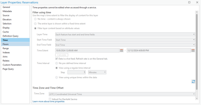

Hello @MelissaSalich, may I know if you have configured the time settings on the Reservations layer?
MelissaSalich
Yes, my reservation layer is configured with the time settings.
GauravJobanputra
Thanks for the quick response. May I know if you are on ArcGIS Online or Enterprise? If Online, can you pls share the time settings of the hosted feature layer? If Enterprise, may I know what version and database, and also pls confirm whether you haven't enabled branch versioning.
MelissaSalich
Enterprise v11.3, I have branch versioning enabled.
