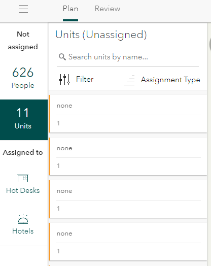

I'm configuring Indoor Space Planner, I followed the steps outlined in the this training video .
How do I configure the display settings for Units in Space Planner?

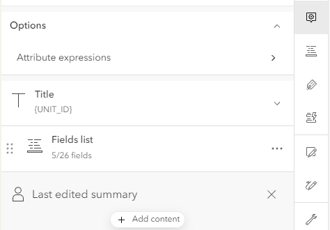

The display settings in Pro were set to take the UNIT_ID, the setting is correct in map viewer.
All my spaces have a UNIT_ID.
Map Viewer SettingsMap Viewer Settings
Space Planner DisplaySpace Planner Display

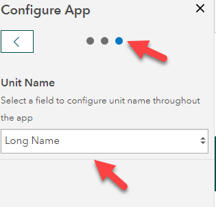

Easy Fix:  Go into the configuration of your Space Planner app & navigate to the last step in the config.   Here is where the field for unit name is defined across the app.  If you were to change it here, you'll achieve what you are looking for.  Note: When doing this, you'll change the way the unit names are displayed across the app.
AndrewBowne
MelissaSalich
Thank you, such an easy fix!
