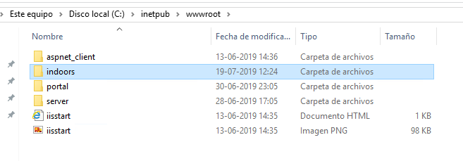

The folder with config.json file, I allowed on a site with IIS available (wwwroot), URL external, with certificate security validate for https:

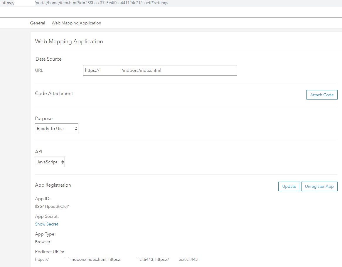

In portal I created a Web Application as Javascript and register the URL:

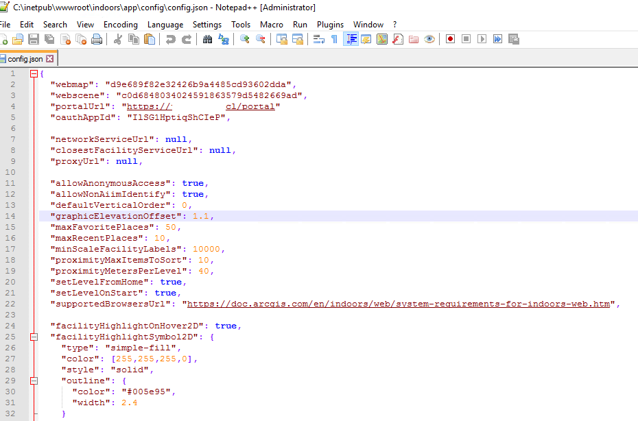

But when I configure the json, the website is not launched:
The ID's from webmaps and webscene is correct, and the ID register also, but I don't know the reason for that this app not run. Can you help me please?
