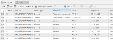

  1. Please share a screenshot of the Units attribute table showing the USE_TYPE column and at least one row with a value of either 'Stairway' or 'Elevator'. (You can black out other data values if they contain sensitive information.)

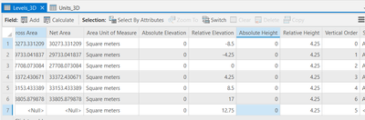

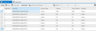

  2. Please share a screenshot of the Levels attribute table showing all the LEVEL_ID and VERTICAL_ORDER values for the Pavillon Adrien-Pouliot facility. (Again, you can redact other data values if they contain sensitive information.)

abarcand
JasonHine123
Thanks Audrey. I'm not seeing any issues in the attributes in the screenshots you shared.
