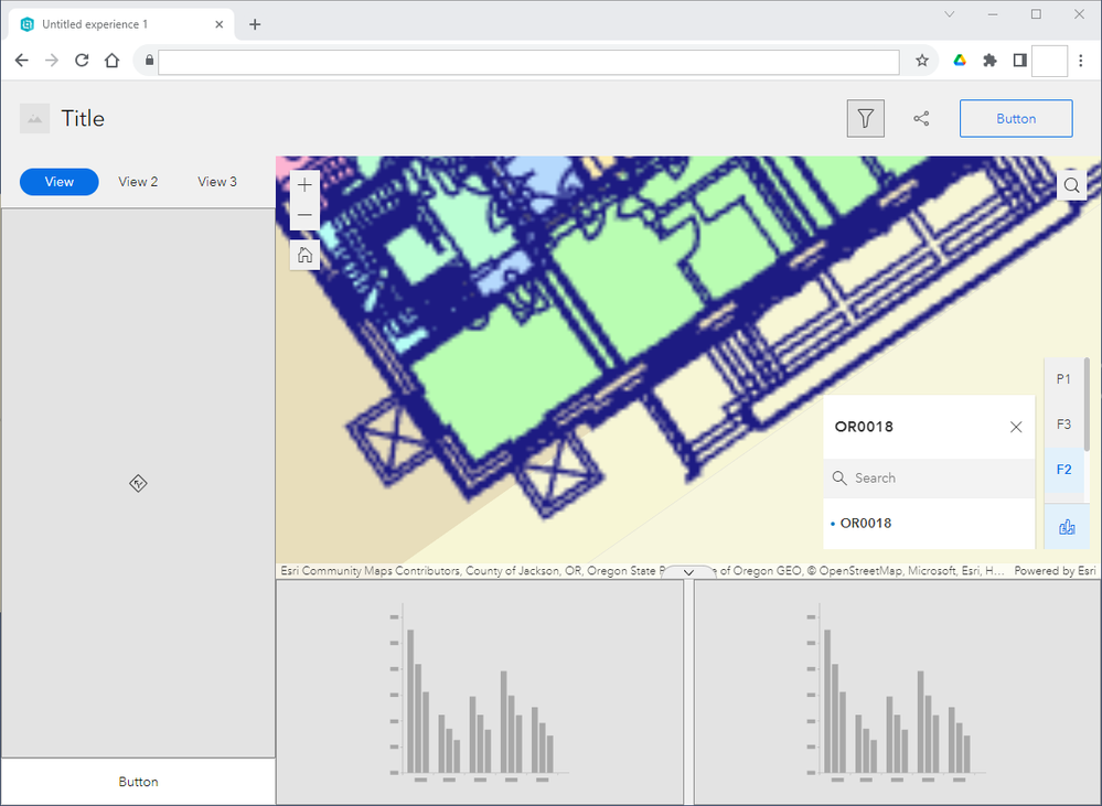

So I added the Floor filter widget in ArcGIS Experience Builder and linked the map per your suggestion (thank you!). It reads the building and floors but when I select the floor and zoom in, the visualization does not render or does not isolate the floors that was selected; all floors are overlapped. Not sure what I am doing wrong.
I ran the Import Floorplans To Indoors Geodatabase using the Excel template and the floor filter works fine on ArcGIS Pro.

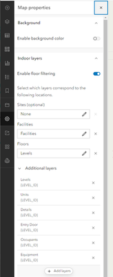

Can you open up the source of the web map's property, and verify if the floor-aware configuration has all the layers?
SamuelSong2
Here is what I have. Floor aware works fine on the map layer. Do I need the other layers like Occupants, Equipment, etc.
Jinho_Kang
Is the floor-aware working now inside the Experience Builder?
Any layers that need to be toggled with the floor-widget have to be configured.
If you do have other layers like occupants or equipment, then yes.
Please have "LEVEL_ID" (and ideally/optional correct geometry-Z) configured under the Additional Layers tab to work.

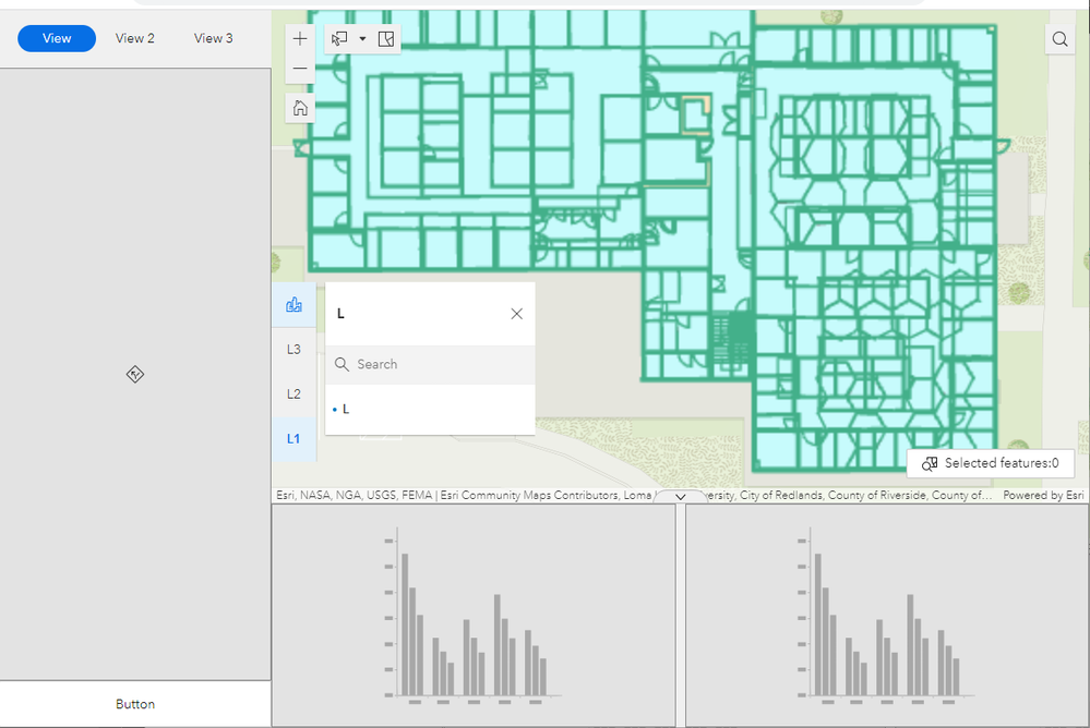

No, the floor filter widget is still not working in Experience Builder.
In order to troubleshoot further, I used a sample Esri Indoors data (IndoorsFPD) to create a floor aware Feature Layer and added the Floor Filter widget in Experience Builder and got the same issues. It identifies the floor labels but it does not cycle through all the floors when I selected them individually; not to mention space data are overlapped and blurry.
Could this be a bug?
