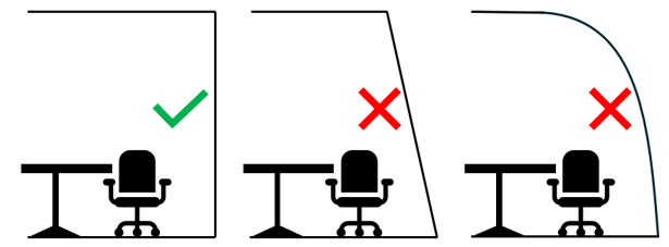

Regarding the architecture being scanned, walls must be vertical. The ArcGIS Pro tool that generates the floor plan will not work for walls that lack a vertical cross-section, such as slanted or arched walls.
Figure 1. Cross-section profiles of walls that are vertical, slanted, or arched. Walls must be vertical
for the scanned data to work with the ArcGIS Pro tools mentioned later in this article.

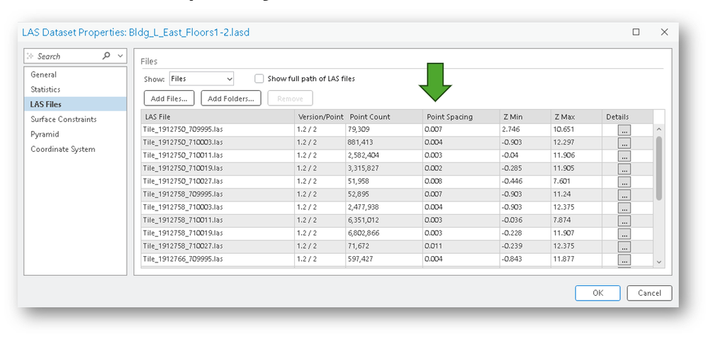

2. Point spacing—The points collected by the device should have an average point spacing of 0.2 inches (5 millimeters) or smaller. Point clouds with larger average point spacings can still be used but the generated floor plans may have more gaps and artifacts. Point spacing is determined by multiple factors including the number of sensors on the device, the distance from the device to the surface being scanned, and scan time. You can do a test scan and use ArcGIS Pro to calculate statistics including average point spacing.
Figure 2. ArcGIS Pro dialog showing Point Spacing values (in meters) for individual LAS files in
a LAS dataset. The average point spacing for the larger LAS files (those with millions of points)
is around 3 millimeters.

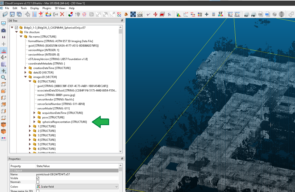

There are tools available to investigate the information in point cloud data files (including LAS). For example, CloudCompare is a free software that can open many common point cloud export file formats (including E57, PTX, PLY, and OBJ) and display detailed information about their contents in a tree view.
Figure 3. Viewing an E57 file in CloudCompare, with a tree view of the file contents at top-left.
This particular E57 has panoramic (“spherical”) images, as indicated by the arrow.

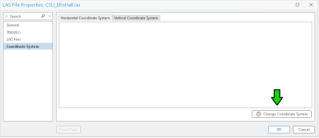

ArcGIS Pro detects when a LAS file contains coordinate system (CS) information. If embedded CS information is not present in the LAS file, consider the following to find it out:
  • Check for a Readme file or other accompanying metadata that might contain CS information.
  • Contact the data provider to ask what CS the point cloud data is in.
  • Try applying a projected coordinate system that is well-suited for the geographic location of the facility, then check whether the point cloud is correctly positioned when added to a map. For example, a facility in Fort Collins, Colorado USA might use State Plane Colorado North, or maybe UTM Zone 13 North. When you view the properties of a LAS file in ArcGIS Pro, you can use the Coordinate System tab to view and change the CS before adding the LAS file to a map to check whether the data appears (possibly as a red box) in the expected geographic location.
Figure 4. You can use the Change Coordinate System
button to assign a coordinate system to a LAS file.

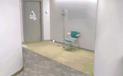

When you want to view LAS data in a 3D scene in ArcGIS Pro, there are some steps you can take to improve the experience:
  1. Pre-process large LAS files—To optimize point cloud data larger than 500 MB for viewing and analysis, use the Tile LAS geoprocessing tool to subdivide large LAS files, then create a LAS dataset from the tiles, and finally use the Build LAS Dataset Pyramid tool on the LAS dataset.
  2. Use the point thinning and scalability options available in ArcGIS Pro to improve performance when viewing the data.
  3. Use keyboard shortcuts to more easily navigate through small indoor spaces. Be sure to try Roam mode!
Figure 5. Navigating an indoor point cloud in a 3D Scene using Roam mode.

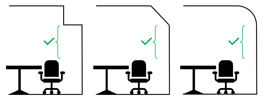

  • To get better results from the Generate Floor Plan From Point Cloud tool, don’t be afraid to experiment with the Z Ranges parameter.  Start with a single z range that goes from the floor all the way to the ceiling. If there’s a lot of noise in the output (typically from furniture, fixtures, or décor with smooth vertical surfaces), try adjusting the z range so it goes from the top of the tallest furniture to the bottom of the lowest ceiling fixture. To reduce noise from wall-mounted fixtures, try using two z ranges, one that goes from the floor up to the bottom of the fixture, and another that goes from the top of the fixture to the ceiling.
  • This was mentioned earlier but bears repeating: The Generate Floor Plan From Point Cloud tool only detects vertical surfaces. If the cross-section of the wall has elevations that are offset or not vertical (see Figure 6 below for some examples), use the Z Ranges parameter to exclude those elevations.
    Figure 6. Cross-section profiles of walls with offset or non-vertical cornices. Suitable z
    ranges are shown that go from the top of the furniture to the bottom of the cornice.
