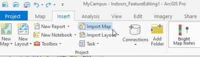

  2. Import the map template by clicking Import Map on the Insert tab.

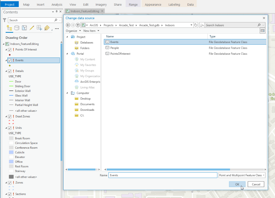

  3. Connect the layers to the feature classes in your indoor dataset by clicking the red exclamation point and navigating to the corresponding feature class in your Indoors geodatabase.

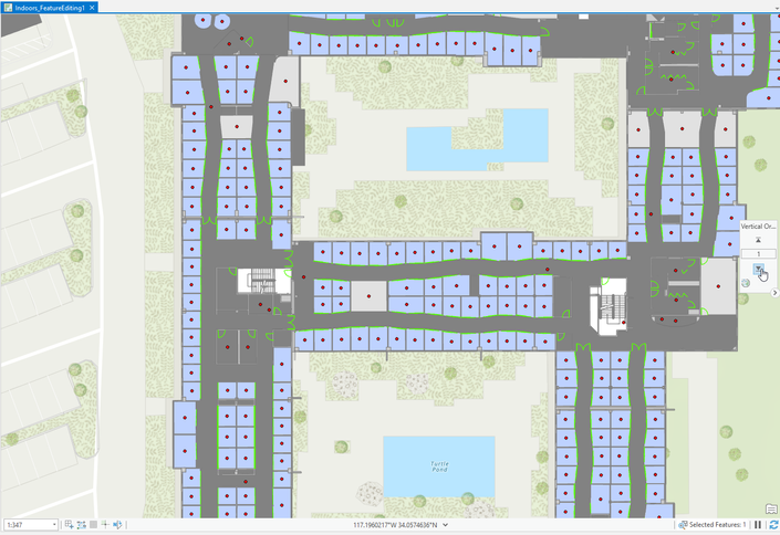

  4. Note that the range slider is enabled by default for all the layers based on vertical order. Click the up and down arrows on the slider to change the level for which data displayed on the map. This is important when creating new features.
    NOTE: If you are using ArcGIS Pro 2.8 or later, you can configure the map as floor aware and use the floor filter to visualize one floor at a time.

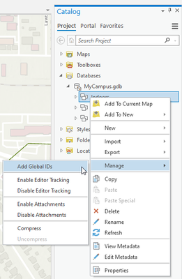

  5. Add Global IDs for each feature dataset in your Indoors geodatabase. Global IDs are required to enable attribute rules. You can add Global IDs from the Catalog pane by right clicking a feature dataset, clicking Manage, and clicking Add Global IDs.

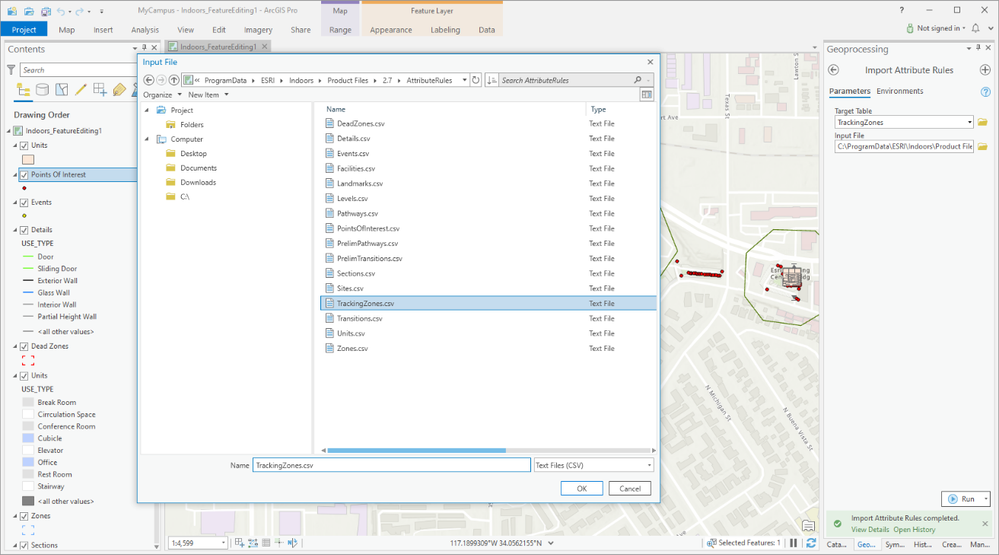

  6. Import attribute rules using the Import Attribute Rules geoprocessing tool. Each feature class in the Indoors geodatabase is associated with a .csv rules file from the product data installation package. You must run the tool for each feature class in the Indoors model to import the associated .csv file that was downloaded to the following folder: C:\ProgramData\ESRI\Indoors\Product Files\2.7\AttributeRules.

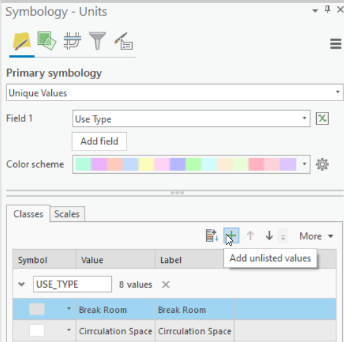

To change the symbology, right click the layer for which you want to adjust the symbology and click Symbology. The Symbology pane appears, and you can adjust the layer’s symbology in many ways, including:
  • Click the Add unlisted values button to individually add feature types you would like to symbolize.
  • Adjust the color scheme for the entire layers using the Color scheme drop-down list, or individually change the colors for each symbol by clicking the symbol in the Symbol column.

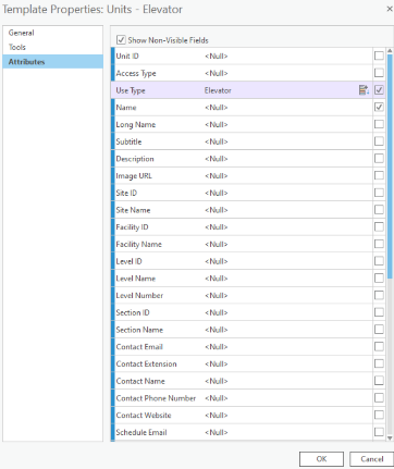

  3. Inspect the pre-configured templates:
    1. Right click an existing template in the layer and click Properties.
    2. In the Template Properties dialog box click Attributes and note which fields have the check box checked.
    3. Click OK.
  4. Import the updated symbology as a template by clicking New and clicking Template to create an individual template or Template For Layer to create templates for each symbol value in the layer.
  5. The Template Properties dialog box appears. Under General, give the template a name and description.
  6. Click Attributes and check the check boxes next to the fields noted in step 3. These are the fields you will be prompted to populate manually when creating a new feature.

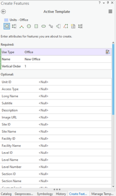

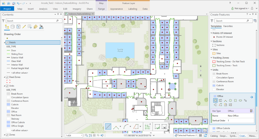

You can use your map template to quickly create new features from the Create Features pane. To access the Create Features pane, click Create in the Features group on the Edit tab. Clicking a feature template from the list indicates the fields that must be manually populated when creating a new feature. The rest of the required attributes are automatically calculated based on the feature’s spatial location and vertical order, which corresponds to the level on which the feature is located. You can access or update the optional attributes for the feature from the Active Template page by clicking the blue arrow next to the feature template in the Create Features pane.
Example – Create a new office in the Units feature class

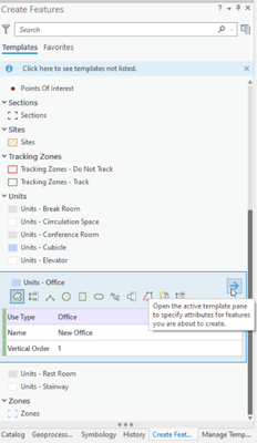

  1. On the Edit tab, in the Features group, click Create to open the Create Features pane.
  2. In the Templates list, expand Units if necessary, and click the Units – Office template.
    The required parameter fields appear.
  3. For Use Type, select Office, add a name in the Name field, and set the Vertical Order. The vertical order must match the vertical order indicated on the range slider.
  4. Optionally, click the blue arrow to view or update optional fields. Fields that are required by the Indoors model, such as Facility ID and Facility Name, will be automatically populated based on the feature’s geometry when you create it.
  5. Use the Polygon tool to create the unit feature by drawing the polygon on the map, or by right clicking and setting x, y, and z coordinates for the polygon segments.
  6. Right click the Units layer in the Contents pane, click Attribute Table, and locate the new office feature. The USE_TYPE, NAME, and VERTICAL_ORDER fields are populated based on what you entered in step 3. All the other fields required by the Indoors model are automatically populated by the attribute rules based on the new feature’s geometry. These fields include AREA_UM, AREA_GROSS, SITE_ID, SITE_NAME, FACILITY_ID, FACILITY_NAME, LEVEL_ID, LEVEL_NAME, UNIT_ID, HEIGHT_RELATIVE, HEIGHT_ABSOLUTE, ELEVEATION_RELATIVE, ELEVATION_ABSOLUTE.

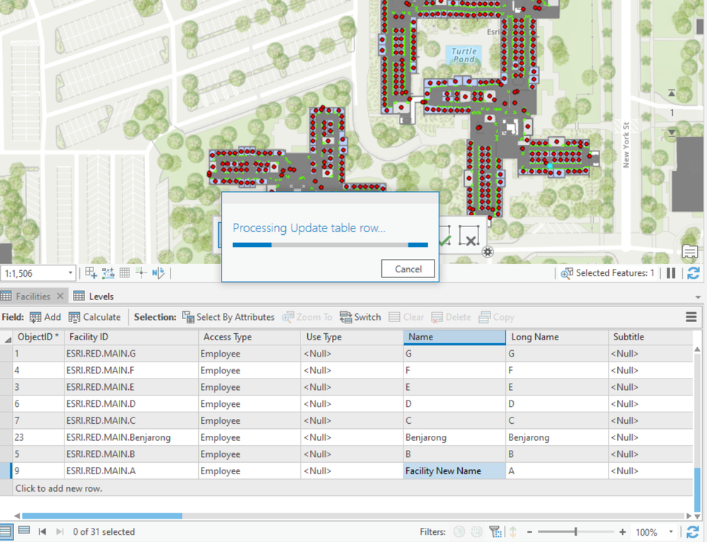

Example – Update the name of a facility in the Facilities feature class
  1. Right click the Facilities feature class in the Contents pane and click Attribute Table.
  2. Update the Name field for the facility you want to update.
  3. Click outside the attribute field. Depending on your indoor data, it may take awhile to complete the update and a Processing Update table row dialog box may appear. This is expected, as the attribute rule is populating the new facility name throughout the feature classes in your geodatabase that conform to the Indoors model.

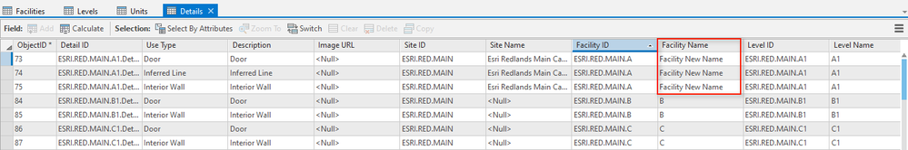

  4. Open the attribute table for the Details feature class and scroll to a details feature in the newly named facility. The new name is populated in the FACILITY_NAME attribute field.
