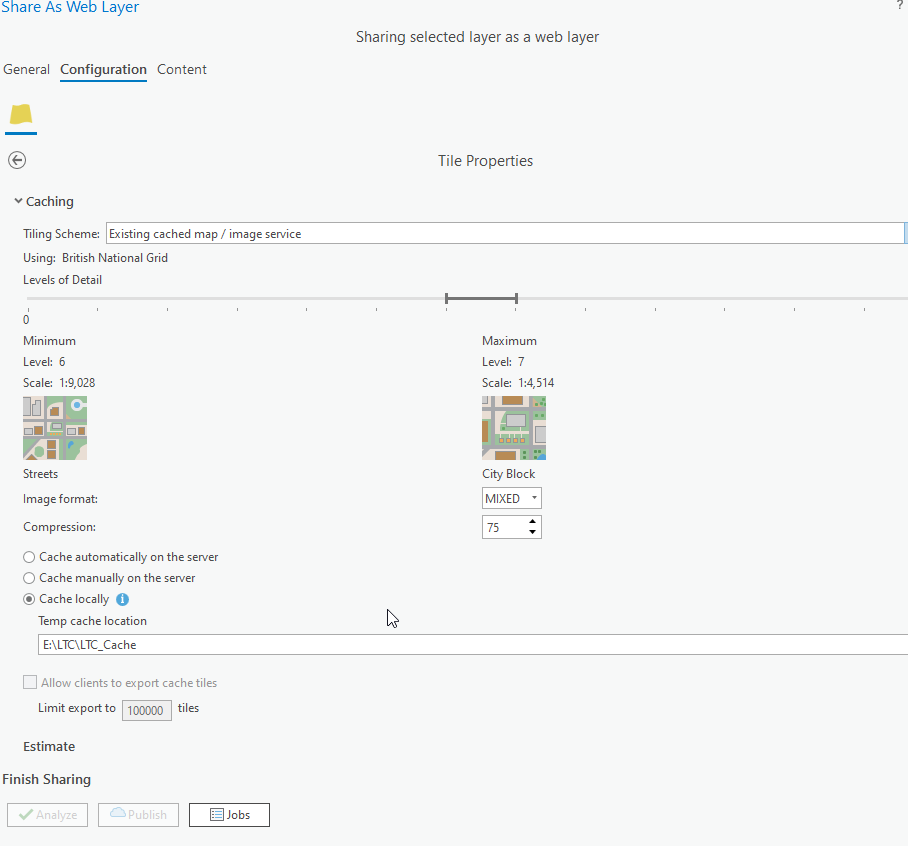

How can I remove unnecessary  white areas from Tilled Imagery?  In Arc Pro these areas are not visible. There are no  No Data Values in this imagery when using in Pro.  I have tried masking No Data, but when I cache it and upload to Enterprise, I still get white areas.
My workflow :
Share as Tile
Apply Tilling scheme from Existing Tilled service
Cache Locally
and upload it online.
I share the image as web layer by ticking the box "Tile"

Hello again,
I have expanded Scale levels  and changed Image format for Tilling. It appears worked for one single image.  Will see how this works on full mosaic dataset.

BenasPekarskis1
Thank you very much  for you input.
As you said, with mosaic data set its much easier. It works fine for mosaic dataset.
Thank you for Image Management Workflows. I have downloaded the toolbox and took a look. I will have to explore it properly. Though I see the tool doesnt have an option to use Tilling Schema from another service  or use our own Schema, this might be an issue for us.
