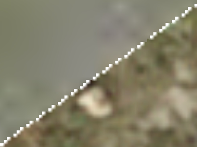

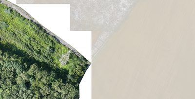

The problem with “Build Footprints” (Radiommetry based) tool is that it has some weird results at the boundary just like on the image below:

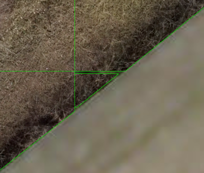

Or this kind  of problem with the footprint:

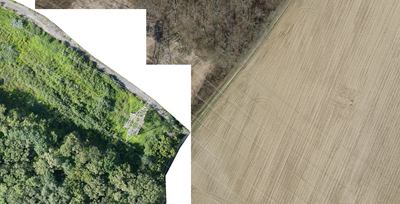

With alpha channel activated (symbology Alpha=Band_4), transition is slightly better but not ideal either:
Any idea what could be done to avoid this problem ?

To resolve the issue on edges of the footprint, use the shrink footprints option (part of build footprints) to bring the footprints in a small amount.
The vertical artifact you have is likely to be from the edge between two input image tiles. Do ensure you run Build Footprints for such tiled imagery with the maintain sheet cut option. Also it is better to have much bigger image tiles and preferably remove the tiling with no overlap. It can always create some issues when re-projecting. There is also a merge function that you can merge many rasters into a single time. I would not recommend with too many rasters (>100)
