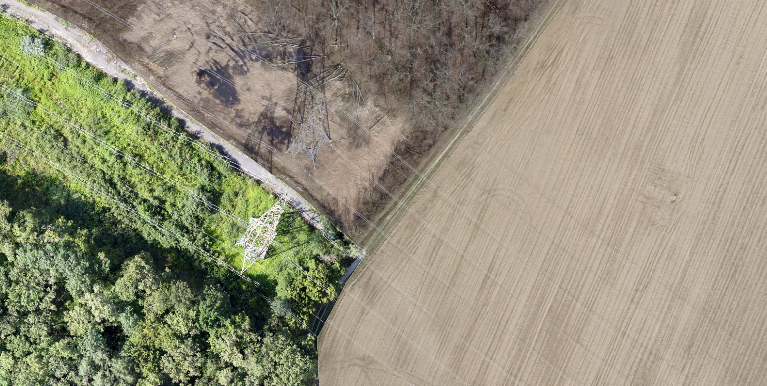

Hello Mosaic dataset experts,
I have 2 datasets, one 3 bands (RGB) and the second one 4 bands (RGB-Alpha).
I create for each dataset a source mosaic dataset and then I create a Derived mosaic dataset to be able to access via one source the 2 datasets.
When I display the 2 source datasets separately and configure in the symbology for the RGB-Alpha datasets Alpha=Band_4 the display is great: OK.
But when I display the Derived mosaic dataset the Alpha channel of the RGB-Alpha source mosaic dataset is not detected, and the display is not what is expected.
When I turn in the symbology Alpha=Band_4 this symbology is at some point applied to the entire Derived Mosaic Dataset while one of the source mosaic dataset doesn’t have an Alpha Channel. The display is still not what is expected.
Is there any solution to make the Derived Mosaic Dataset mixing 2 source mosaic dataset which only one of them have an Alpha Channel and still display it correctly?

Hello Nicolas,
In these situations where you have mixed image sources, we like to use the “Build Footprints” geoprocessing tool. This effectively sets the extent of each image to the edge of the imagery and does not include padding as you have shown.
Then in the Mosaic Dataset “defaults” make the setting “Always Clip Raster to it’s Footprint”. This then ensures that no image appears outside of the image extent.
Also, if you have built overviews and they have included the padding, you will have to reconsider rebuilding the overviews as when they are built, they will honour the image footprint extent.

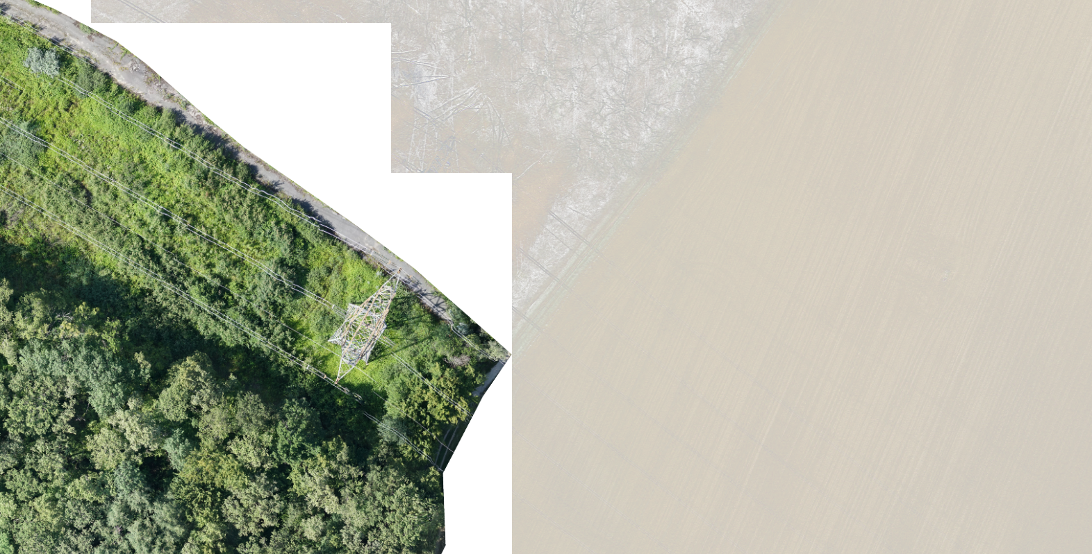

The problem with “Build Footprints” (Radiommetry based) tool is that it has some weird results at the boundary just like on the image below:

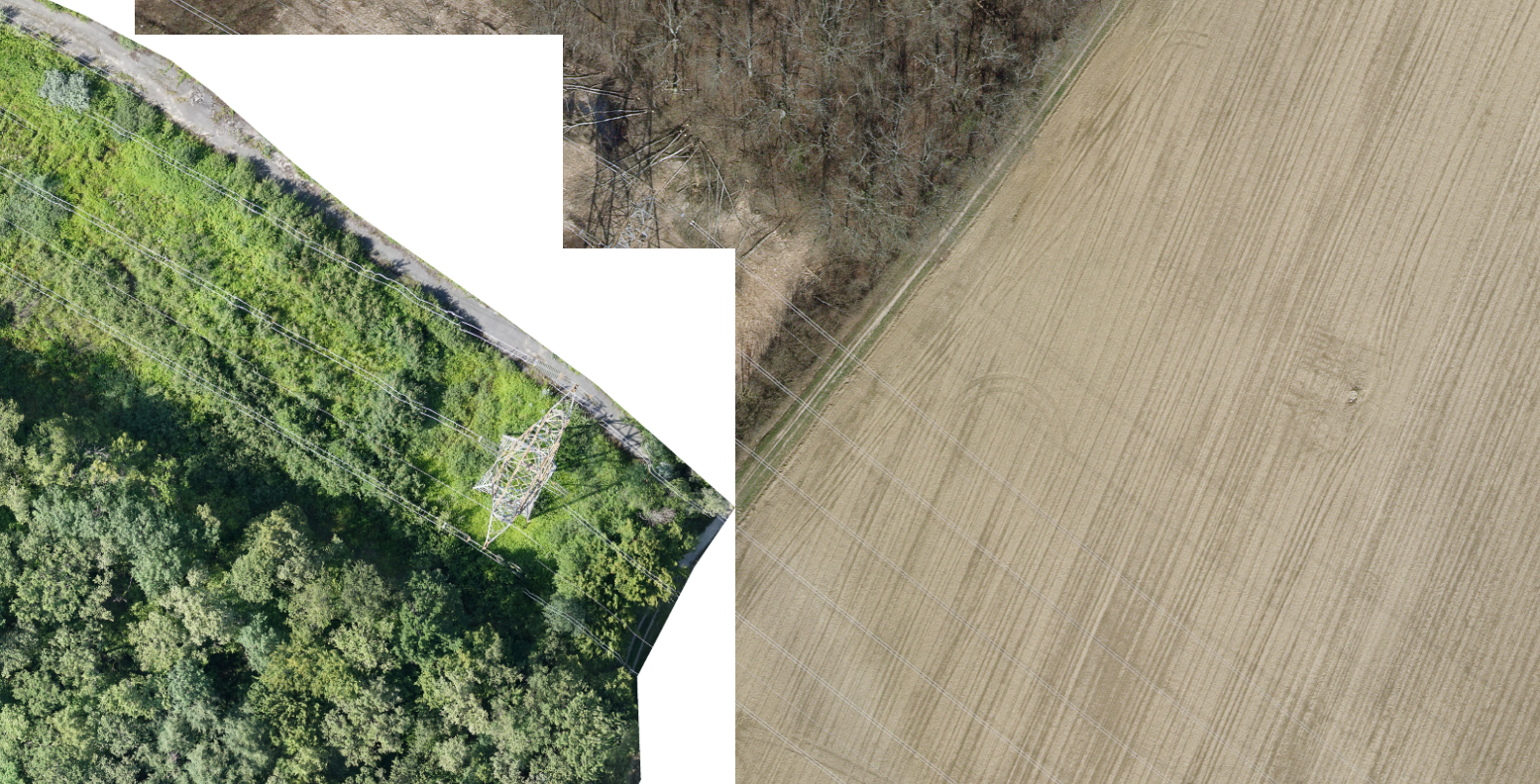

With alpha channel activated (symbology Alpha=Band_4), transition is slightly better but not ideal either:
Any idea what could be done to avoid this problem ?

PeterBecker
To resolve the issue on edges of the footprint, use the shrink footprints option (part of build footprints) to bring the footprints in a small amount.
The vertical artifact you have is likely to be from the edge between two input image tiles. Do ensure you run Build Footprints for such tiled imagery with the maintain sheet cut option. Also it is better to have much bigger image tiles and preferably remove the tiling with no overlap. It can always create some issues when re-projecting. There is also a merge function that you can merge many rasters into a single time. I would not recommend with too many rasters (>100)
Also note that you can have the edges blended if you want. To do this convert the footprint to seamlines or create a new seamline polygon that defines the required edge and then set up blend. (This is another reason you will want to merge or reduce the number of images). Set the blend to be inside and define the required width
