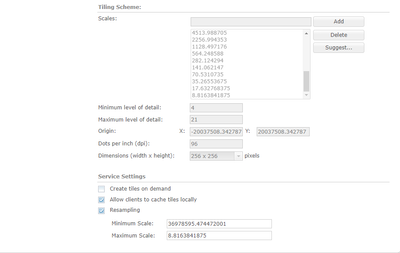

I have run into this behavior as well. My cache has tiles down to 1:282.124294, but I'd like them to resample and be visible down to very very large scales, so have enabled resampling down to 1:8163841875:
When I open the service in either Map Viewer, the service doesn't display past the tiled 1:282.
