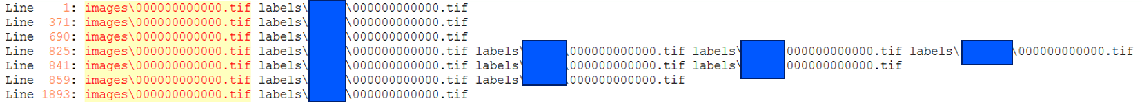

For example, when using a mosaic dataset of rasters (6 different rasters) the map.txt showcases that the numbering of images restarts every now and then. Probably when it iterates on the next raster dataset in the mosaic, it starts again from 0. Is that normal behaviour? Then the mapping is wrong because in the output image folder of .tif, the same number cannot exists twice (gets overwritten?).
For example:
images\000000000000.tif  is supposed to be associated with 6 different levels of labels while it cannot be. When 000000000000.tif is visualized it only correspond to the 1st dataset only, so where does the rest go to.

There is no iteration per imagery, the number continues from images\000000000000.tif to images\000000001108.tif without any sign of restarting numbering or confusion. But it looks like it only takes into account one raster instead of the full folder.

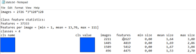

Also the stats.txt is completely different.

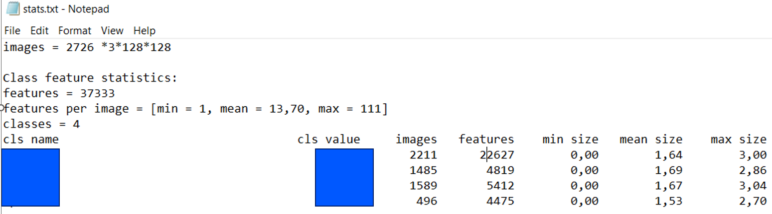

When mosaic is used (way more images are created and features are taken into account but mapping I cannot udnerstand):

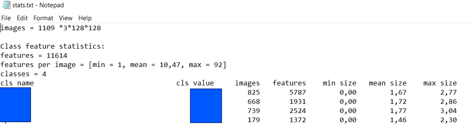

When folder of rasters is used (it looks like not all images in the raster folder are taken into account):

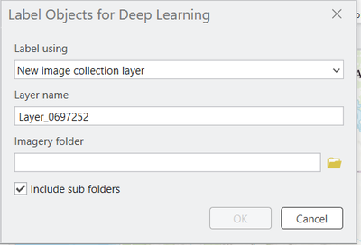

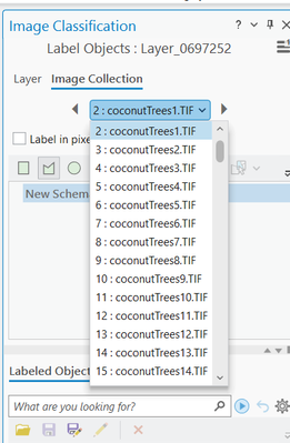

Workflow 1: when using a folder
  1. Select a folder
2. Use the Image Collection tab, make sure to select the right image to label on

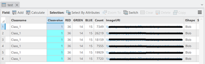

3. Save the labels and check paths in the ImageURI field
The tool will honor the ImageURI.
Workflow 2: when using a mosaic folder
  1. Select a mosaic dataset layer from the content pane
2. Use the Image Collection tab, make sure to select the right image to label on (as shown in the folder workflow above
3. Save the labels and check paths in the ImageURI field (as shown in the folder workflow above

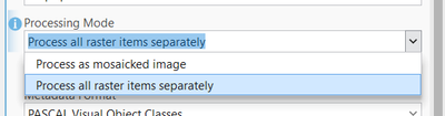

4. Use the ‘Export Training Data for Deep Learning’ tool with the ‘Processing Mode option selected’. You likely want to select the “Process all raster items separately”

ChelseaVSmith
I have a similar concern, there needs to be more documentation on how the fields are created and what they are used for. I am trying to understand if I can use labels I have already created on a new raster, I have added addtional bands that I now want to include in my training samples, e.g. can I update the ImageURL field to a new composite raster? I also don't seem to have the option to change processing mode in the export training data for deep learning tool?
