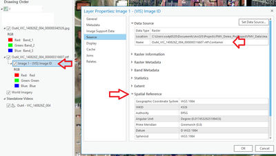

I just tested with Pro 2.8.1, and the *.ntf format images have a coordinate system defined.  Are you querying properties of the NTF layer, or the image inside the NTF container?

Thanks @CodyBenkelman The marker in the image attached is 42x30 cm but measures ~126x80 cm on the map... so about 3x larger. The NTF image comes up with an Unknown Coordinate System.
