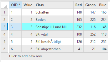

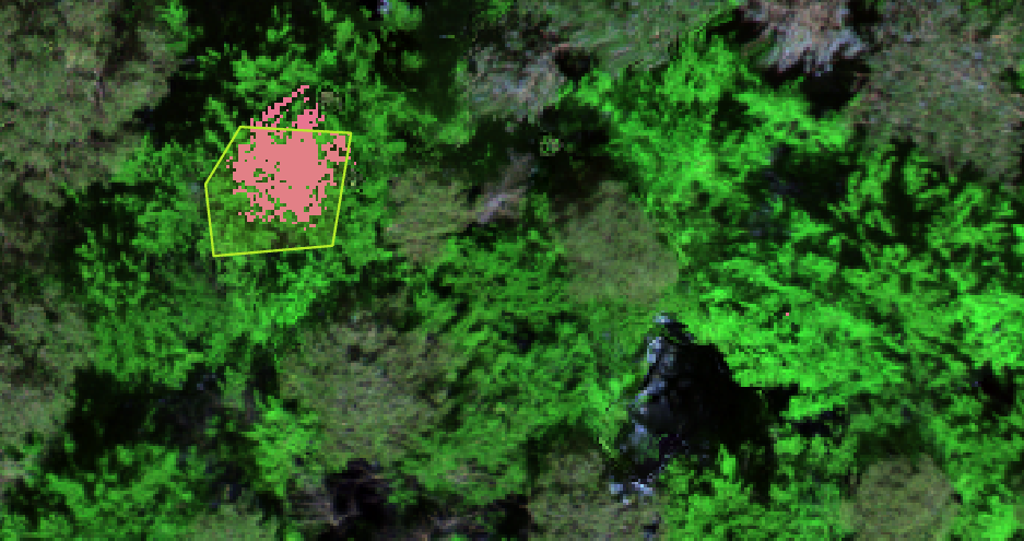

I have managed to solve the problem - there was accidently set another "Additional Input Raster". Removing it from the "Export Training Data" Tool solved it.
But the results of the classification with U Net Pixel classification i not satisfactory. Within my created Classified Raster, there are only a few pixel of only one class classified which are mostly located within the are of my traing samples.
I attached a image of the Raster Attribut Table and a example of some of the classified pixels.
Anybody knows what i did wrong? I used the standard parameters of each geoprocessing tool.
Thanks!
PavanYadav
Hi @Relssuak
I would check the quality of the model and more importantly how it's performing on both training and validation datasets. You can review it in the model_metrics.html. Here are some general suggestions to improve the model:
1. Add more samples
2. Add variety of random samples that represent your entire area of interest.
3. Make sure each classes have enough number of samples
4. When training try to use a large number for epochs e.g. 500, if possible. The tool might not see model improving let's say after 100 epochs so it should stop here (for this situation you can use the 'Stop when model stops improving)
Cheers!
Pavan
