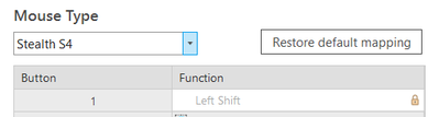

I have a new computer (Windows 11 Pro, Version 23H2). I followed these instructions to set up the Stealth Mouse S4-Z, but it is not detected by ArcGIS Pro:
I tried to plug it in into different USB ports, with no effect.
