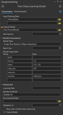

Hello, happy Monday, so I trained a model using training for the purpose of segmenting tree canopies. However, when I use the `Classify Pixels Using Deep Learning` and provide the trained model as input, I get this error:
Error 003569 Invalid deep learning model type. Expected model type NULL, ImageClassification, Pix2PixHD, Pix2Pix, CycleGAN, or SuperResolution.
How can I fix this? I am using ArcGIS Pro 3.1.1
Below are the parameters I used to train the model:
Question | Analyze | Visualize
Ed_
by MVP Regular Contributor
Because I trained the model using Single Shot Detector, it was not compatible with Classify Pixels using Deep Learning. So then I trained the model again using PSPNet and it solved the error.
