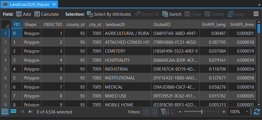

Has anyone had issues with the units in downloaded line and polygon layers since the big update to the Open Data Portal interface a month or two ago?
To be specific, my organization recently started getting a large number of questions about unexpectedly tiny numbers for areas and lengths in some of our Open Data Portal layers.  Specifically, everything seem to be measured in decimal degrees, even though the input data layers were all in international feet.  It appears that the layers, which are show values in feet/square feet in the table view in the Open Data Portal table view, get reprojected into WGS 1984 coordinates as part of the export-and-download process.  Thus, we wind up with extremely unhelpful decimal degree values for length and area while our users are asking questions like "How many acres of agricultural land are in this county?" and "How many miles of road are within our jurisdiction?"
To reproduce:
  1. Go to this dataset: https://maps-semcog.opendata.arcgis.com/datasets/land-use-2020/explore?location=42.439822%2C-83.2869...
  2. Observe shape_area values generally in on the order of magnitude of 10,000-1,000,000 for each row
  3. Download the shapefile for this layer, open in ArcGIS Pro, check the attribute table
  4. Observe values in the same fields that are mostly well below 1 (see image below)
Attribute Table containing decimal degree unitsAttribute Table containing decimal degree units

You have no control over the shape length and area fields.
You will have to "copy" the projected values into new fields (eg Area_unit, Length_unit where unit is your choice of planar units) so that they persist over to the reprojected file.
This will have to be done before unprojecting back to Geographic Coordinates

Has this always been necessary with the Open Data Portal?  We've only been getting questions about it from our users for a few months, I assumed that they'd added the automatic reprojection with the recent updates to the Open Data Portal interface.
Either way, it seems really strange that they let you preview the data, then have a hidden function that modifies it when someone clicks "download."
