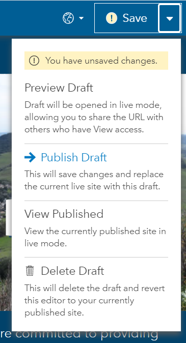

I am working on updating my organizations AGOL content to HTTPS rather than HTTP.  I need to change a few things related to that on one of our Hub Sites: County of San Luis Obispo
When I try to save it after making some edits, such as changing image URLs to HTTPS, I get an orange error message along the bottom of the screen that stays for a few seconds and then goes away.  The error message is:
"TypeError: @esri/hub-sites: drafts only belong to a site or a page item model"
The site's "save" button has an exclamation point next to it:
and when I click the dropdown next to "save," it has this list of options.  None of them get me any closer to saving my edits.
This site was created before I joined my organization; it might be somewhat "old."  I have recently created other Hub Sites and have never had this issue before.

we pushed a hotfix for this issue. refresh your site / page and try again. thanks again for letting us know--our automated tests don't cover these older types `Web Mapping Application` that the app used in 2016 before we launched the "Hub" item types. We're looking at ways we can automate this case so we avoid breaking things in the future.
