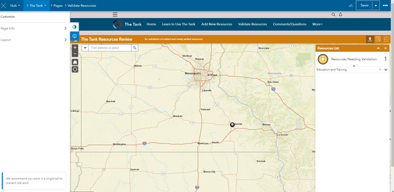

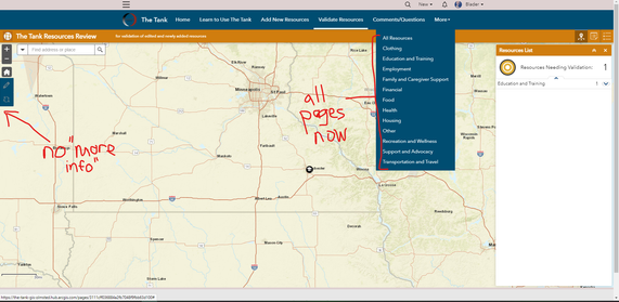

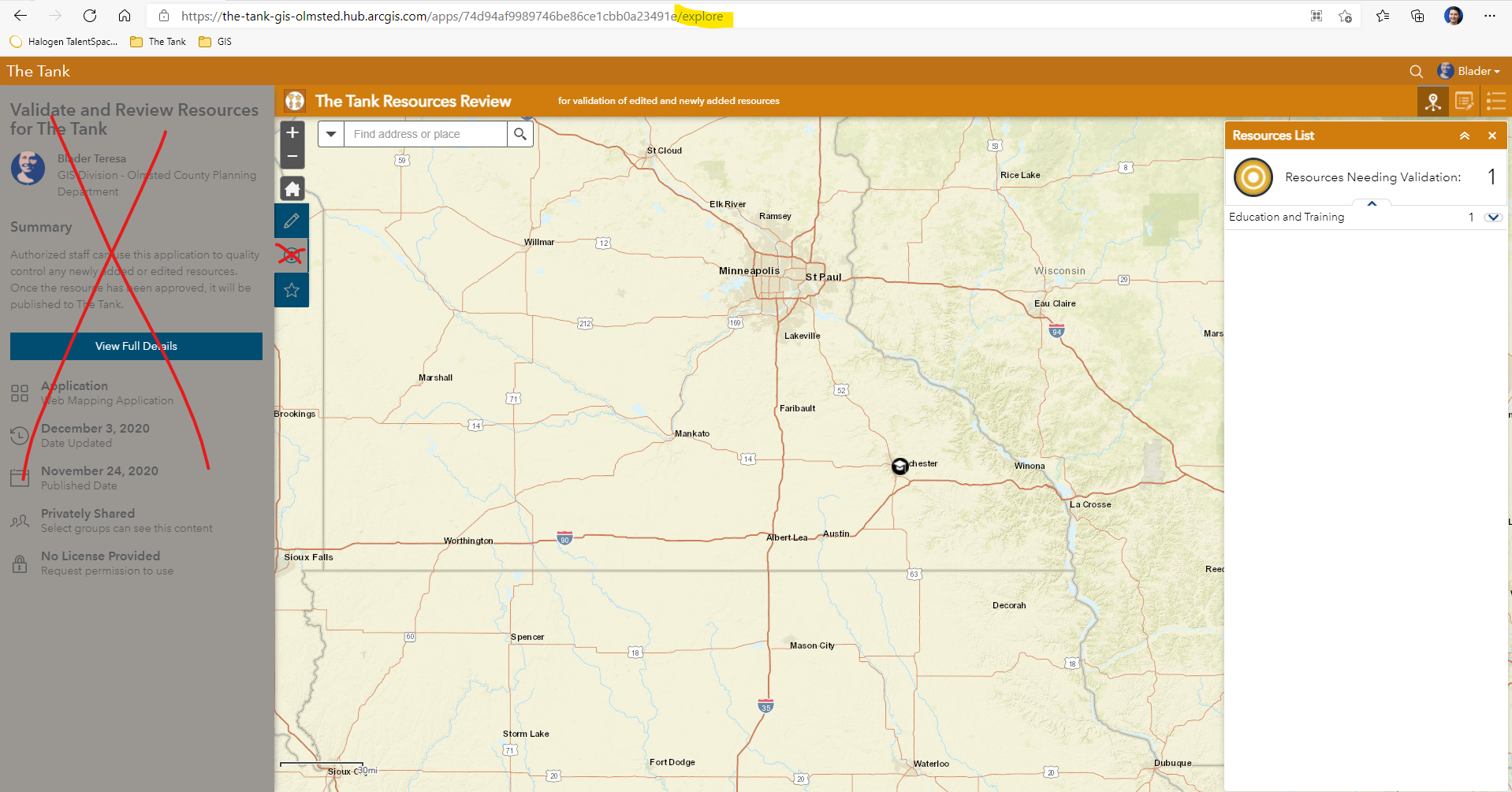

I'll clarify that I want to have the apps open within the Hub, I want them embedded, I just don't want that "More Info" Panel to open automatically. And I'd like to have the choice to not have the creator name and profile image appear. That is irrelevant to the Hub/Application users and makes me a little uncomfortable (since I'm the creator and not the person they need to reach out to if there are problems). This feature seems to be related to the new Hub release as the users of my hub configuration reached out to me today. In concept, I think it's a nice feature, I just want to be able to turn it off and modify what information about the application appears in the More Info side panel.
My solution was to painfully add each application into a page via the Application Widget (There are 16). Once I did that, the More Info Side panel does not appear. Would have been nice to just some how toggle the More Info Side Panel... but alas... time was of the essence.
